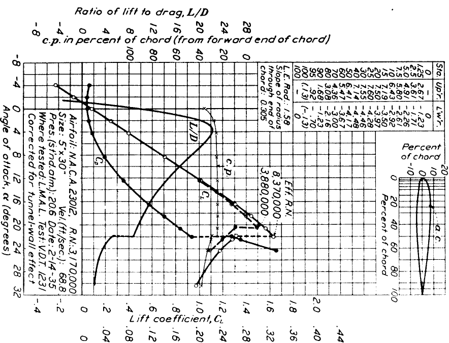

The airfoil is a 23012, 12% thickness/chord ratio; I'm sure a quick Google will provide the salient data. Chord is 5'6" approx.

Dana:
Here's the 23012 data sheet.Attached FilesBob Gustafson
