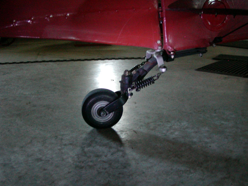

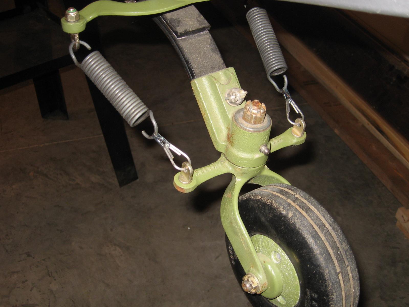

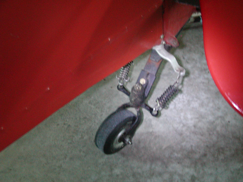

      Re: Heath tailwheel
      3Dreaming,
      This is on my 1940 BL65
      Bob Waldron
      1940 Taylorcraft BL-65
      SkyHarbor airpark Webster, MN
      eMail address nc18681 then an @ sign then HOTMAIL . Com
        Re: Heath tailwheel
        Bob,
        Perfect! I will use the eyebolts to reduce spring angle as you and others have done. I appreciate the pics.....set's my mind at ease.

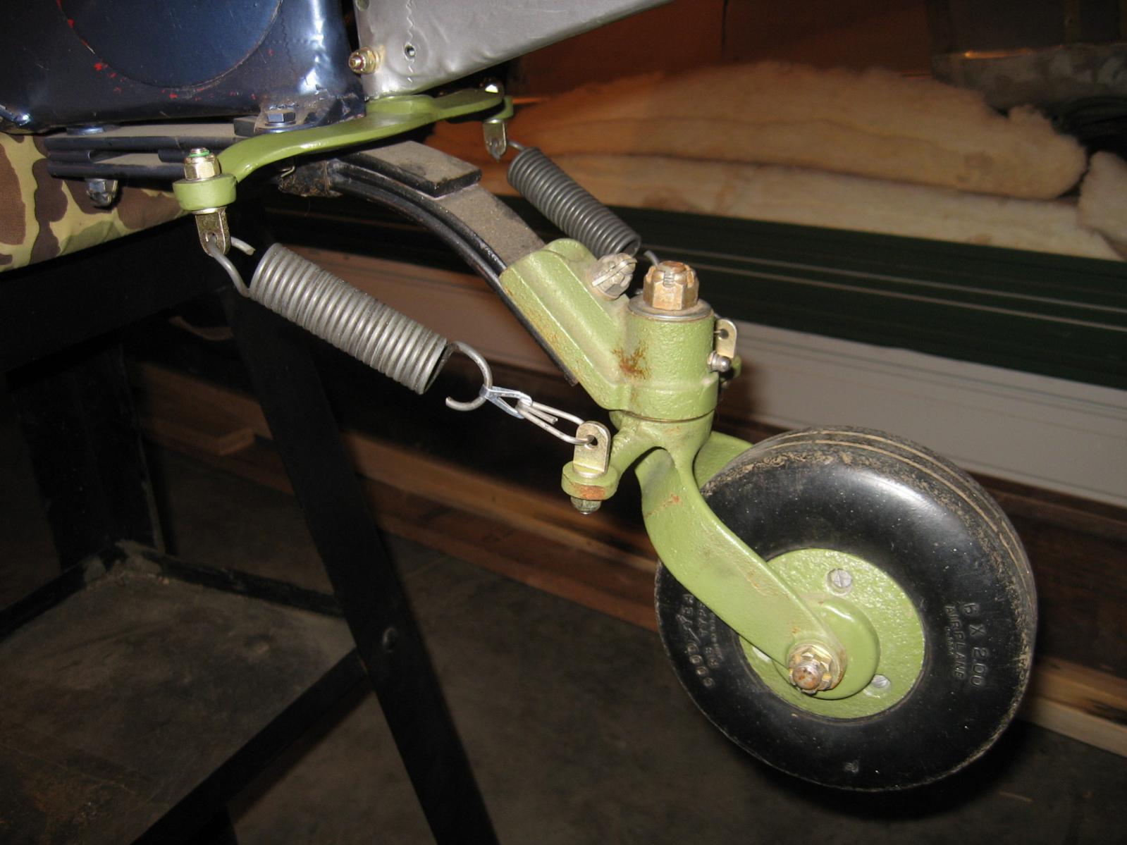

            Re: Heath tailwheel
            How does this look? I will mouse the clips and spring ends after paint and at re-assembly.
