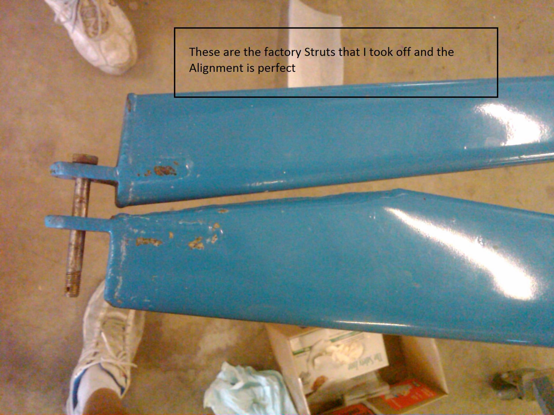

    I am new to the Forum here but bought a F-21 about a year ago and have totally gone thru the plane and made everything perfect...From new paint to making a instrument panel. I was going to go for the first flight this weekend after I mounted my new Univair struts... I spent all day painting them Friday and ready to go on today .... Well I sent some pictures of what happend... Did I just get a bad batch of struts or is this the kind of quality they think that we pay for ?? I cannot believe how bad they fit. I would never fly the plane with them on their like that. At the Joint, the Struts actually Rubs together !! I am now here asking you guys have you seen this kind of krap before and where can I buy struts that fit perfect ?

          The gap in your picture is nothing to worry about, its esthetics that's all.
          The rubbing is a problem. That needs to be addressed. If the interference is allowed to remain it could/might result in spreading and cracking of the fuselage fitting.

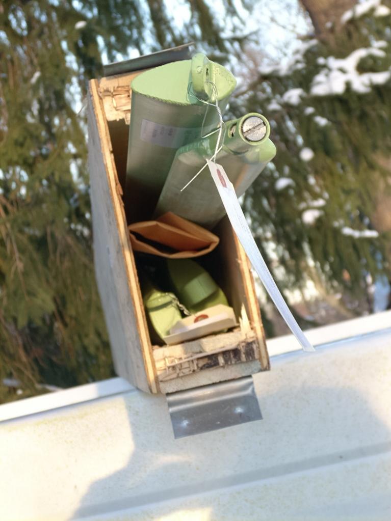

                          My struts came from Alaska in a box made of 2x4s and plywood, with small air filled plastic rings to keep them from chafing.
