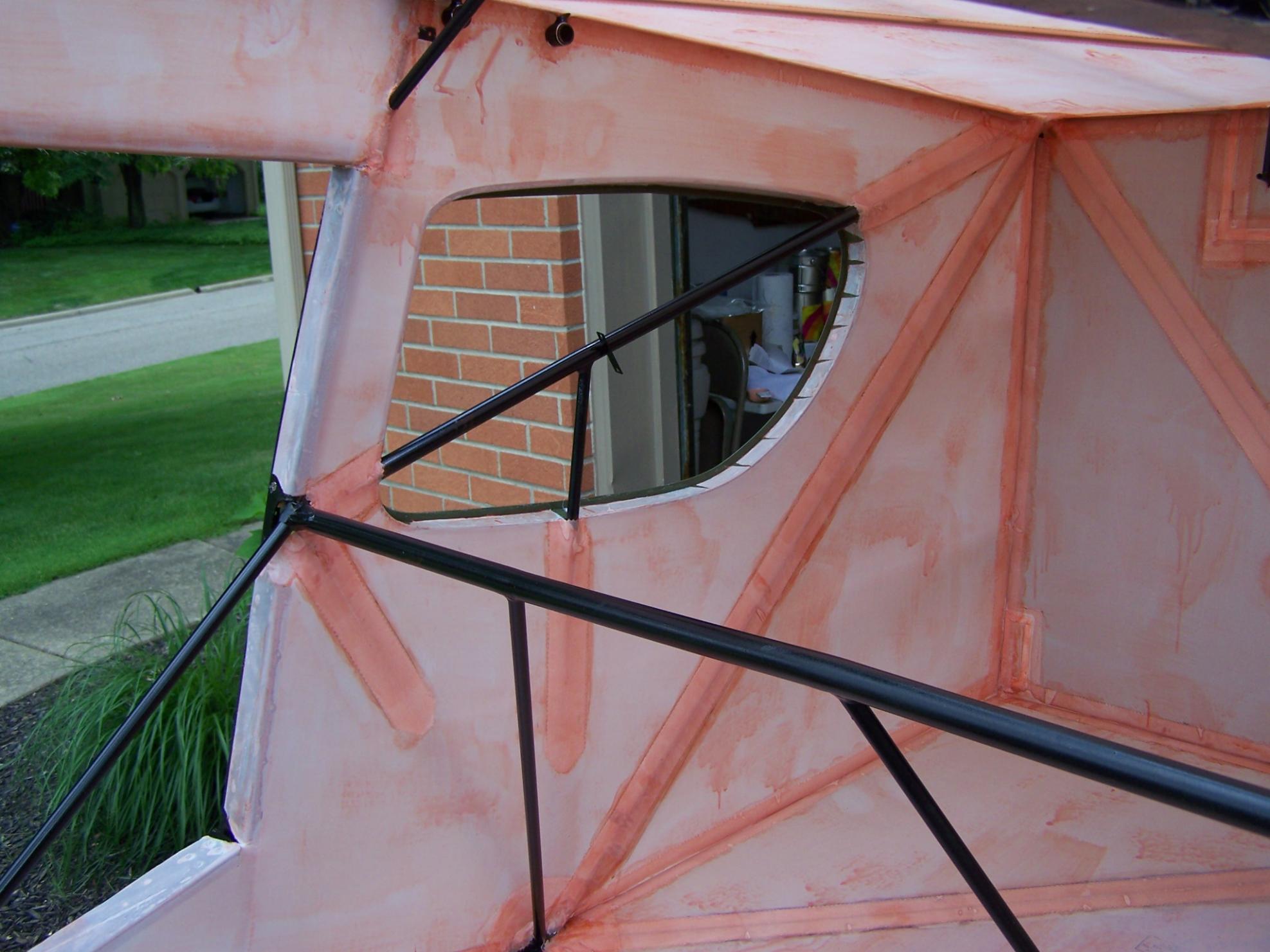

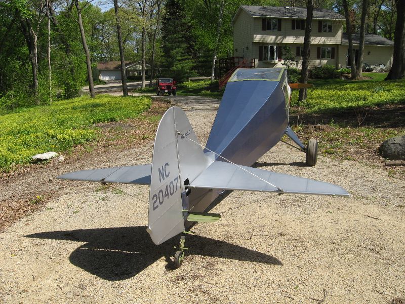

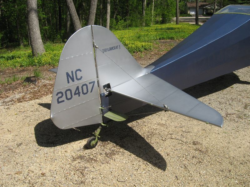

Starting to look like a plane again. I mounted the tail surfaces yesterday.
Looks like a plane again.......
Re: Looks like a plane again.......

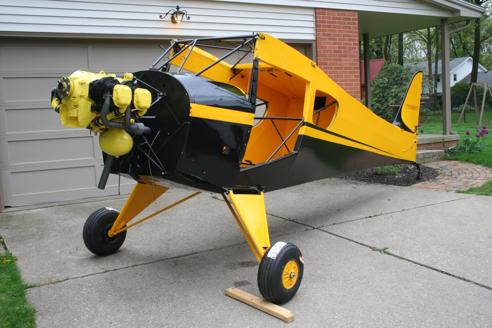

Looking good Mike. We just hung the engine yesterday so I know how it feels!Ryan Newell

HEY!!! Both of those look really nice. That sure makes it exciting when a collection of parts starts looking like an airplane. Congratulations!

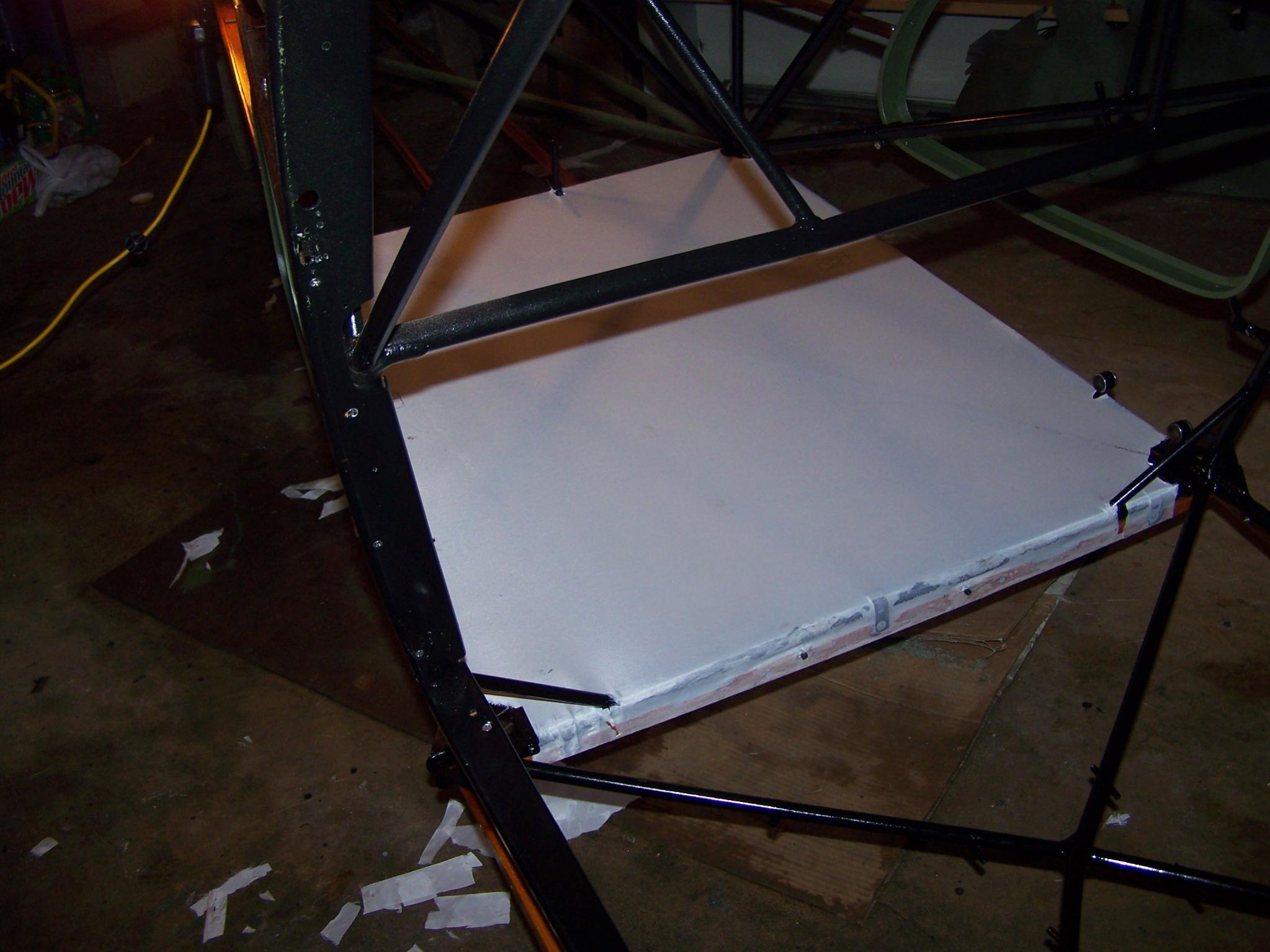

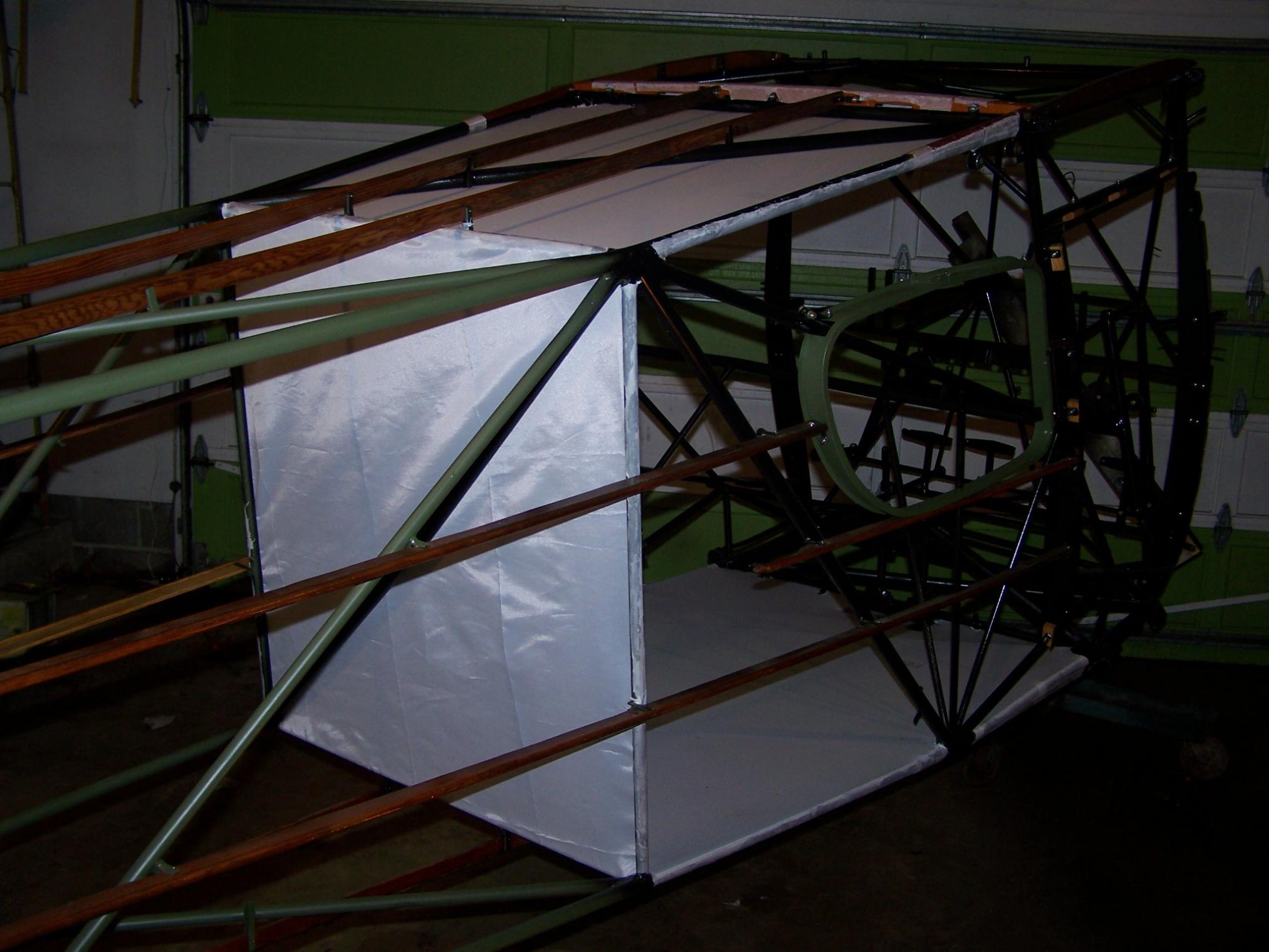

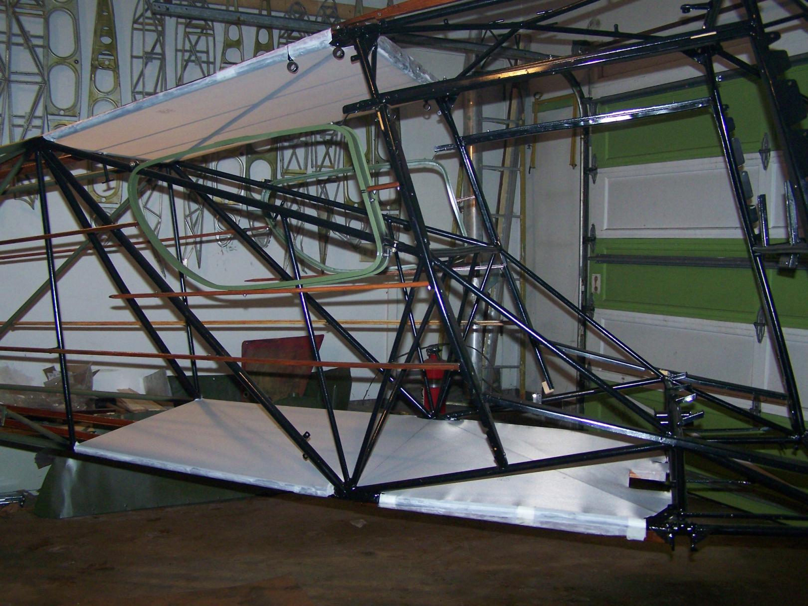

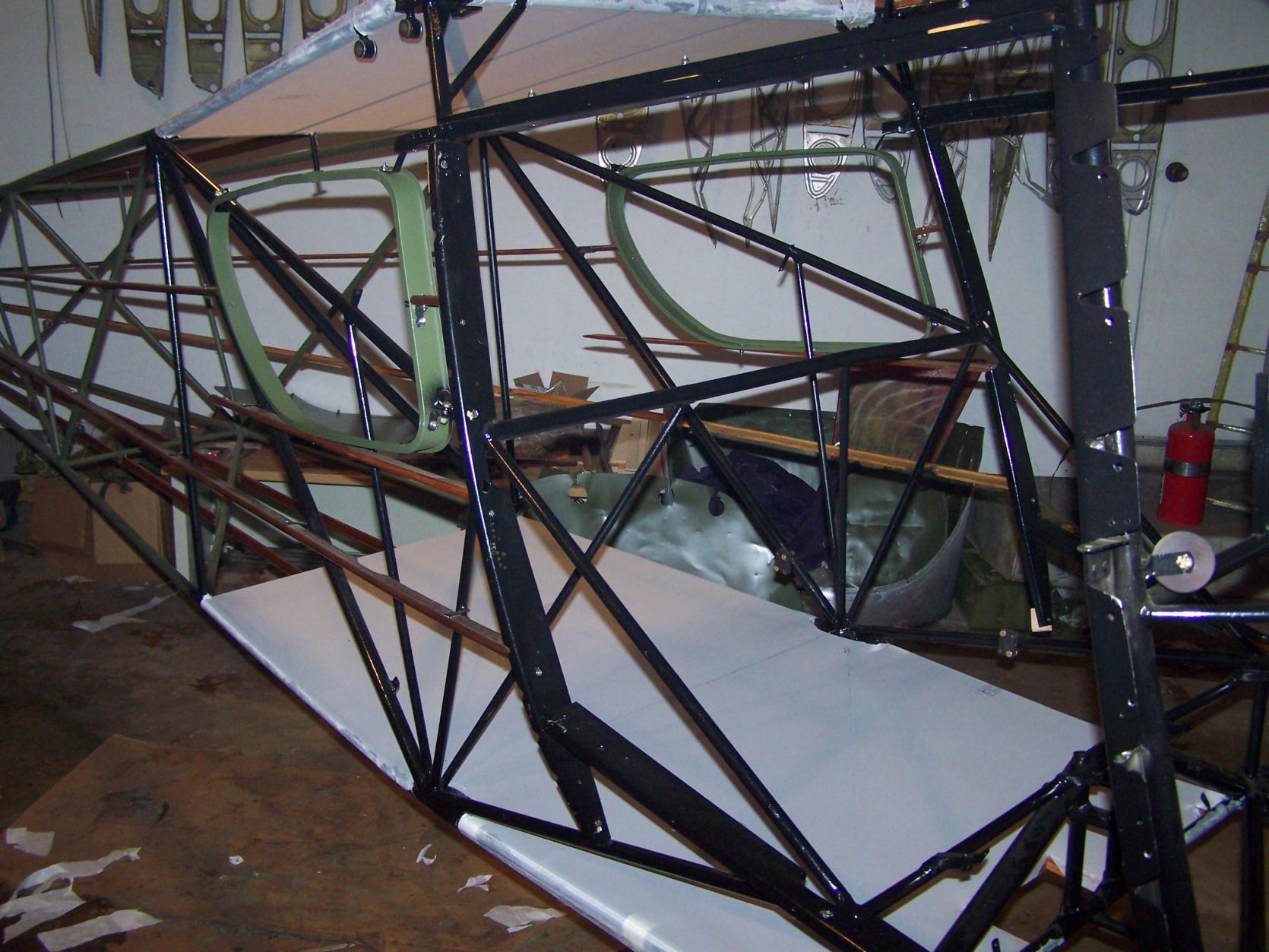

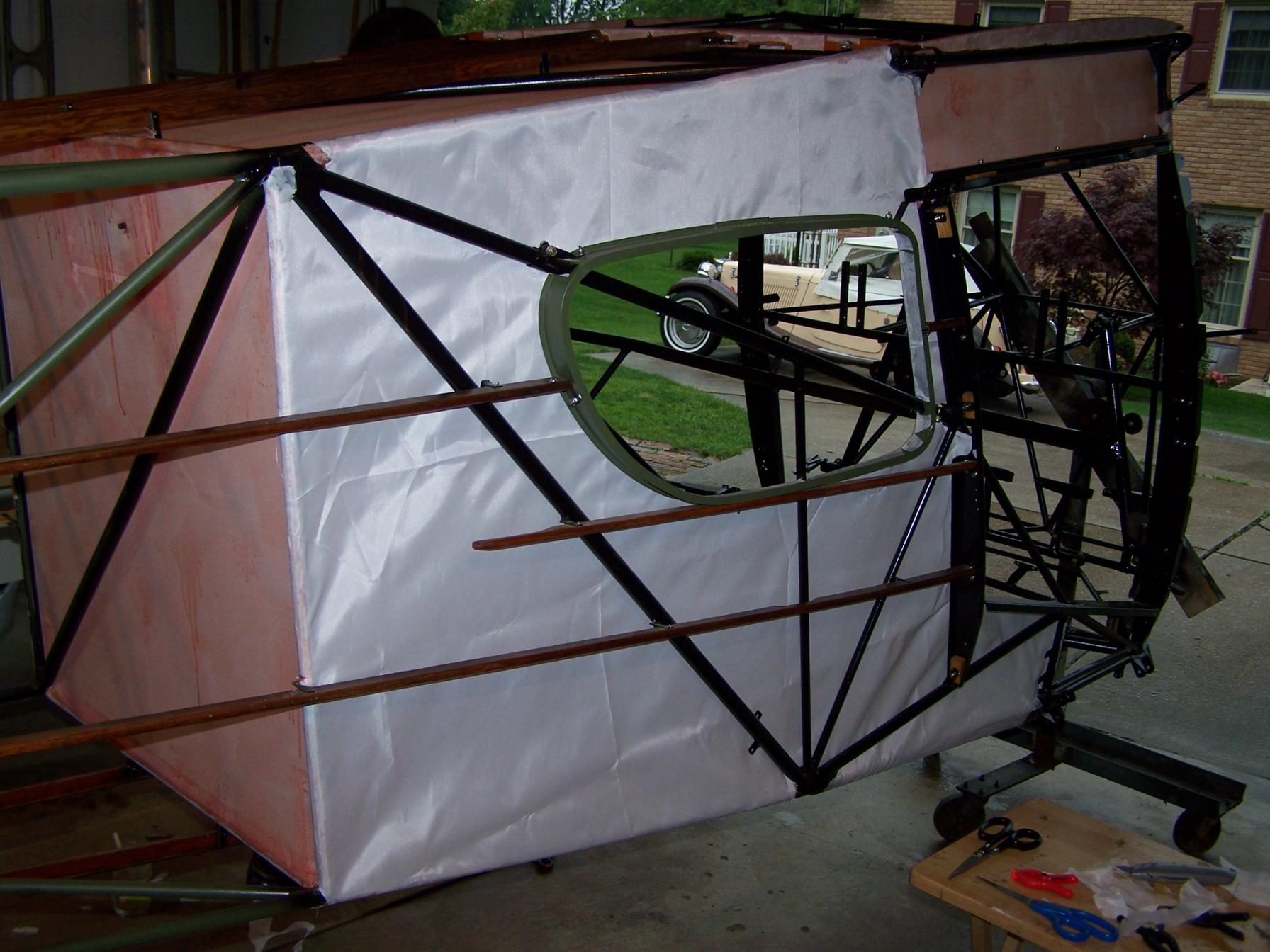

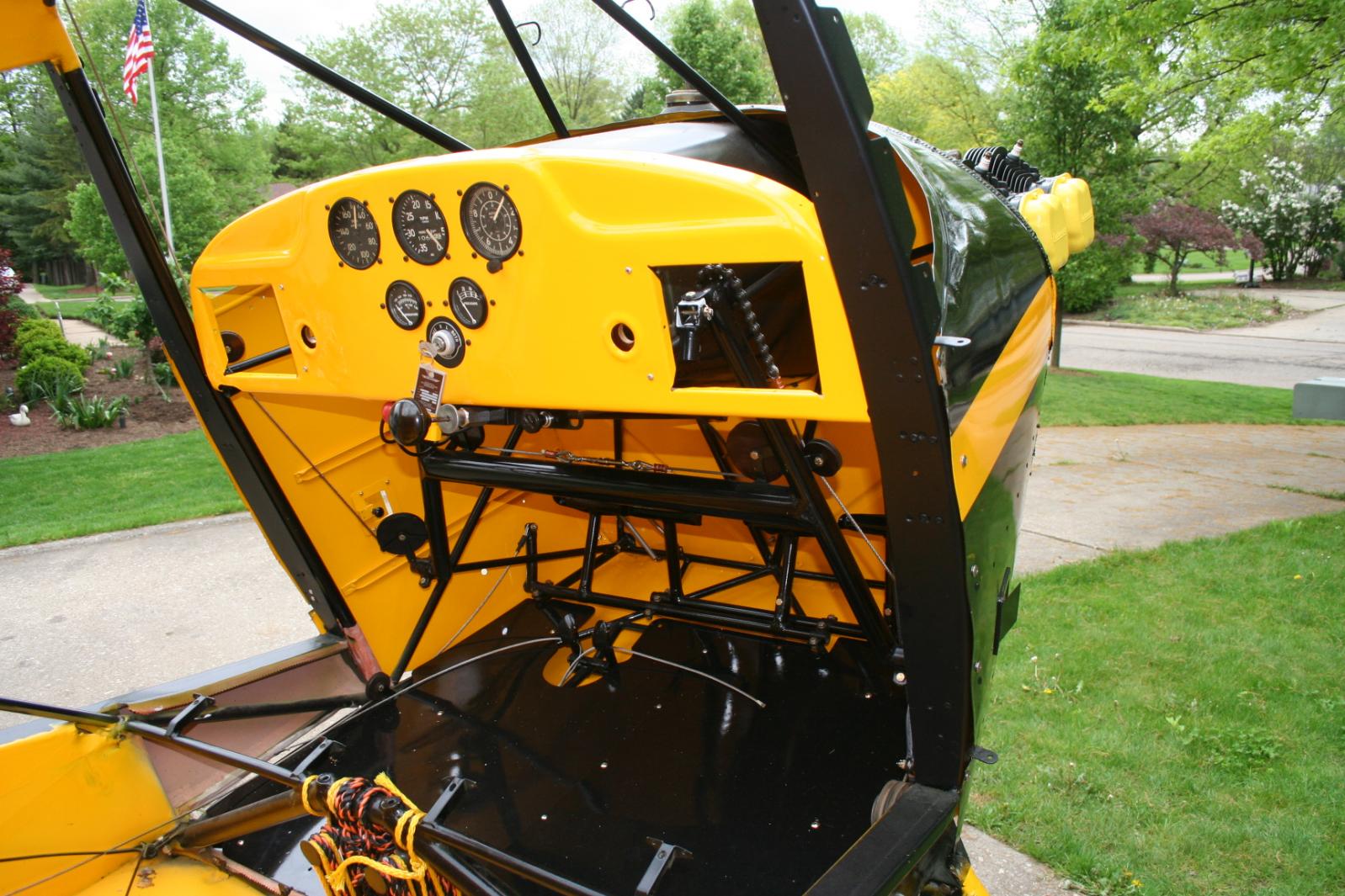

Ryan, I am interested in how you attached the fabric on the inside of your baggage area. If you think about it, next time you are taking pictures I sure would appreciate a couple of shots of what your interior fabric is attached to at the top and bottom.
I purchased the Harer STC and, as I recall, it shows a small piece of wood running along the edge of the flooring, but it is a little vague about how the upper portion of the fabric is attached.
Please keep us all posted with more pictures as you progress.Richard Pearson
Hope these help Rich. I did the bottom piece first, then the top, then back, followed by the sides. My Old flight instructor did his cub this way. Others would know if that is how all cubs are done as I am not sure.Ryan Newell
