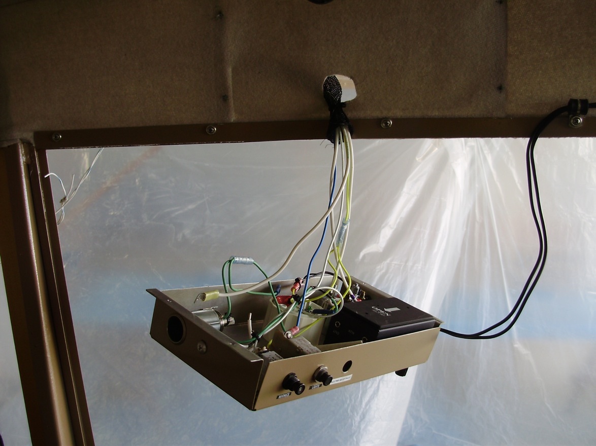

      The radio lash-up right side plugs are: Audio out, Microphone in, and power. I did not use the Icom combined phone plug because I was wiring directly into a circuit board on my own design and the individual plugs for audio and mic were more convenient. My circuit board is just a slick way to route a lot of wires into the intercom... (two PTTs for example)
      The power/charger input does seem to disable the radio. That is a weird design which I did not see in the radio manual before. If I re-do the PTTs I might try the DPDT switch and disable the charger input during transmit. I am most interested in how well your circuit operates in that regard.
      Question... Does anyone know if you can you power (not just recharge) the radio with the overpriced cigarette lighter charger plug that Icom sells? Probably not, but the advertising is ambiguous because it says charge/operating cord.
      I like your idea of mounting the radio up higher. It is tough to see the numeric display down by the floor. I agree that an ammeter is useful. A voltmeter only tells you the status of the gel cel. The ammeter tells if the electrons are gozintas or gozoutas relative to the battery. We used a center=zero type ammeter in the wiring shown below.

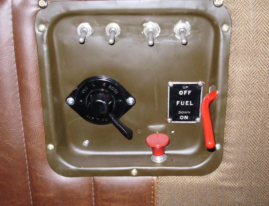

      Here are pics of the Ward Aero Generator mount we are doing right now in Doc's hangar. Looks like a Champ, but it is a generator mount, trust me. Battery is a Long Way from the control box and another long run to the switch panel, so there are circuit breakers on the control box and there are current limiter fuses at the battery and the generator output.
      Inside the box are voltmeter, ammeter, cigarette lighter plug, and intercom.
      Right to left on the switch panel are battery, generator, avionics master, and position lights. I decided to switch the field winding and be able to kill the generator.
