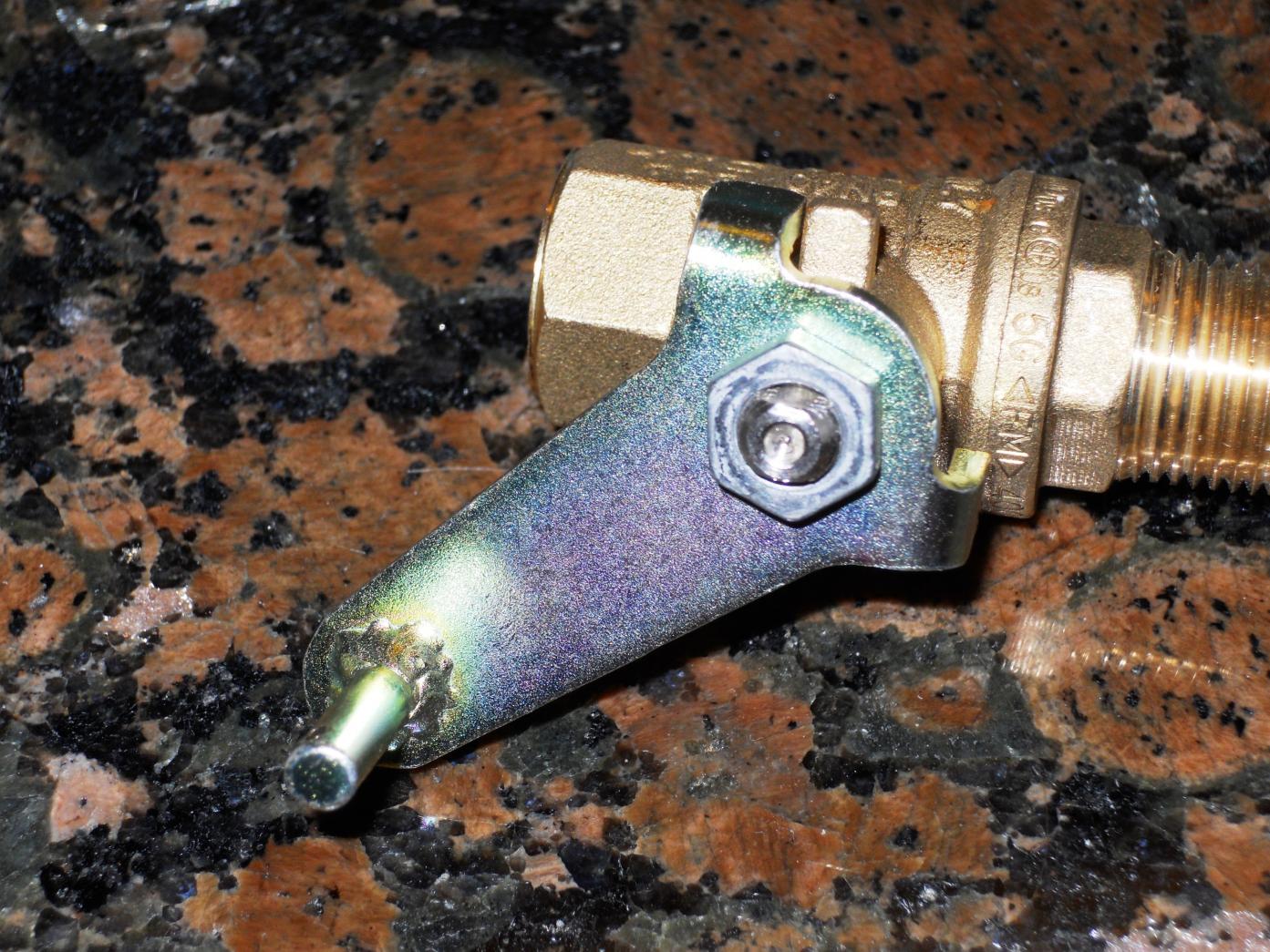

    Yep, part 45 requires a lot of stuff to be put on like the part number, FAA-PMA, and manufacturers information. You guys can hand drill the square hole all you want, I will still have mine punched out when they punch out the handle then I know it is exactly indexed....... Tim

      Those look great, Tim! Can't wait until they're ready for sale!

          Well got some handles back from plating and assembled 3 of them. They look good. Now I just have to get my STC finished and get a PMA, Tim
