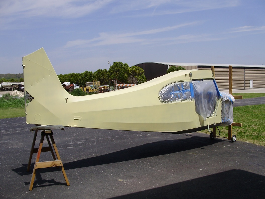

    The photo shows the mounting system and propulsion mechanism used with Doc's Ward generator. We don't want to be accused of hijacking this thread with inferior Brand X flying products.

      Re: Ward Aero wind generator
      P.S. For those who are wondering how a Guppy got into this thread, there are THREE Taylorcrafts just to the right of the above picture! Doc
