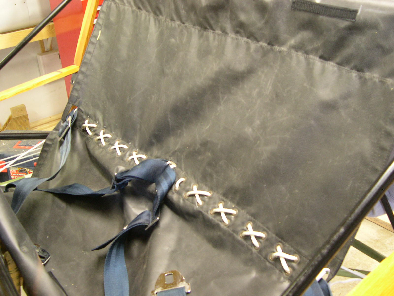

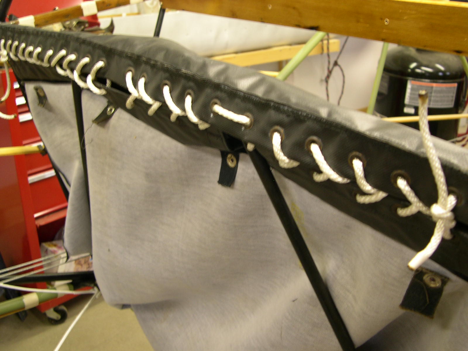

    I need to know the type of knots to use when lacing the seat sling. I plain on using a 1/8" nylon & polypropylene card as the lacing. If this will give me a problem please let me know.

    I used two pieces of extra long 1/4" nylon braid in a "X" lacing pattern (like you'd use to lace up your boots) with a square knot at each end to lock it in place.

                        I have had the best luck with black Dacron. No UV, stretch, or rot issues.
                        1/8" should be heavy enough. Start with a Bowline Knot and pull the strain
                        against it.
