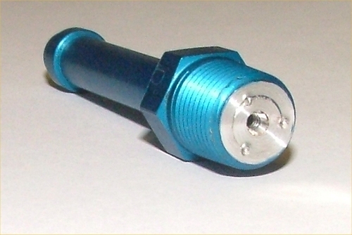

    Edit: make sure you have a restriction in the fitting that screws into the engine...it'll limit the oil loss if the line ever fails.
    The attached photo shows what I did.

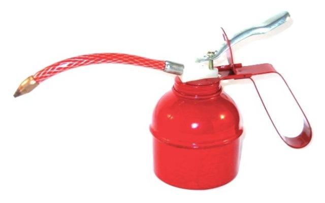

      You can back fill the line and charge the oil pickup with a simple tool. Disconnect the line to the oil pressure gage at a point away from the engine.
      Use an oil can similar to the one pictured with a rubber tube attached. Connect the rubber tube to the line and pump oil into it. It should back fill the line and prime the oil pickup and you don't have to stand behind a moving prop.

        Excellent idea, Tom.
        BTW, I don't stand behind the moving prop using my method...I'm inside the cabin.
        But I still think your idea is better (no engine running required).

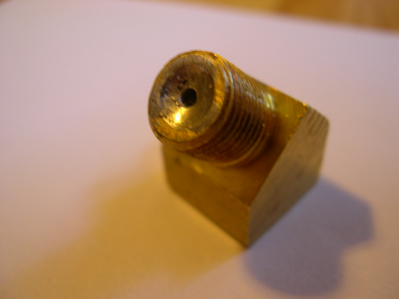

                  The picture shows how I handled the restrictor issue. I used a 45 degree street elbow at the engine which I filled with solder and then drilled. I tried using a drilled rivet as some have suggested, but I couldn't make that work, my rivet kept falling out.
