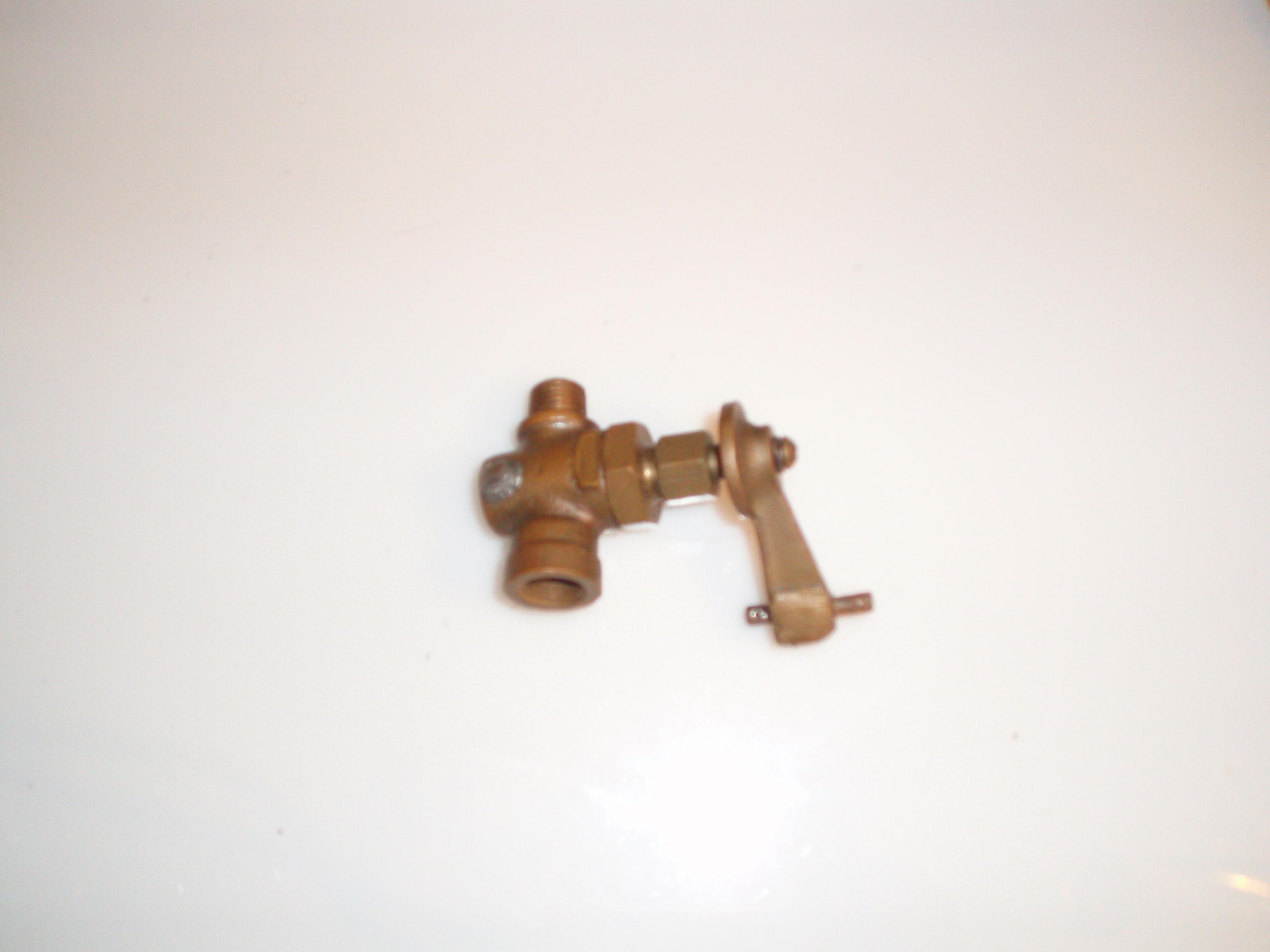

    OK, I have been bitten by the off topic bug. We recently were haveing a discussion on the control arms for the shut off valve under the 12 gal nose tank and Forrest posted a picture of the pre war cast valve. I offered to post the picture of my 45 valve with the arm for it but now I can't find the thread we were talking in! I'll post my picture here and hopefully we can move discussion of the valves to THIS thread so it is under a correct title so we can find it in the future.
    Forrrest, if you still have some of those cast lever arms (and if anyone has one of the valves so I don't have to get out of my plane to turn it off) let me know.

    Stumble thumbs strikes again. The picture didn't attach. Trying again.

      That picture is exactly like the one on my 46 BC12-D.
        Re: Main Tank fuel shut off valves
        They were used up till the cast one came out...... however ;
        a tip: It is recommended that you reach up under the tank to shut it off if it has not been done in a while. You can feel the pressure to turn the valve rather than grabbing the knob and PULLING , you could rip the valve out of the bottom of the tank. Use it once in a while to see tht it works in case you need an emergency shut off sometime....

            Not a problem on my 41 since I ALWAYS reach under to shut it off. The shutoff valve is mounted 90 degrees out so the shaft is facing towards the seat and there is no rod or knob. That's why I am looking for a replacement valve, handle, rod and knob. If I ever needed to shut off the fuel in flight I would have to climb out on the strut to reach the knob.
            I'm a little afraid of in flight fire and not being able to shut the fuel off. Funny part is not one A&P, IA or instructor has seemed the slightest bit worried that the handle can't be turned in flight.
            Is my safety background out of control or are these guys all just missing what is obvious to me?
            Anybody got parts to sell so I can replace mine?
              Like I said, mine is exactly like the picture of yours. The shaft is aimed to the left side. The rod attaches to one side of the lever (rear) and a spring attaches to the front side. The spring is not very heavy but is strong enough to keep the valve from shutting itself off in flight. The spring clip on the knob also helps in that plus it keeps you from pulling the fuel off mistaking it for carb heat knob. In my set up, carb heat knob and fuel shut off knob are side by side.

                Correction, I should have said, "the rod attaches to the long pin on the lever and the spring to the short side pin.
                  It is extremely important that you can shut her off in flight, a shoe lace would do it .....:doh: It is merely a rod with a long bolt in one end for the knob and a flattened end to do over the pin... may send pic if I have one.

                      Hank, mine is a tube a Forrest described with nut brazed on one end to screw the knob into and the other end flattened and drilled. If you had a knob fabricating a tube is quite simple.
