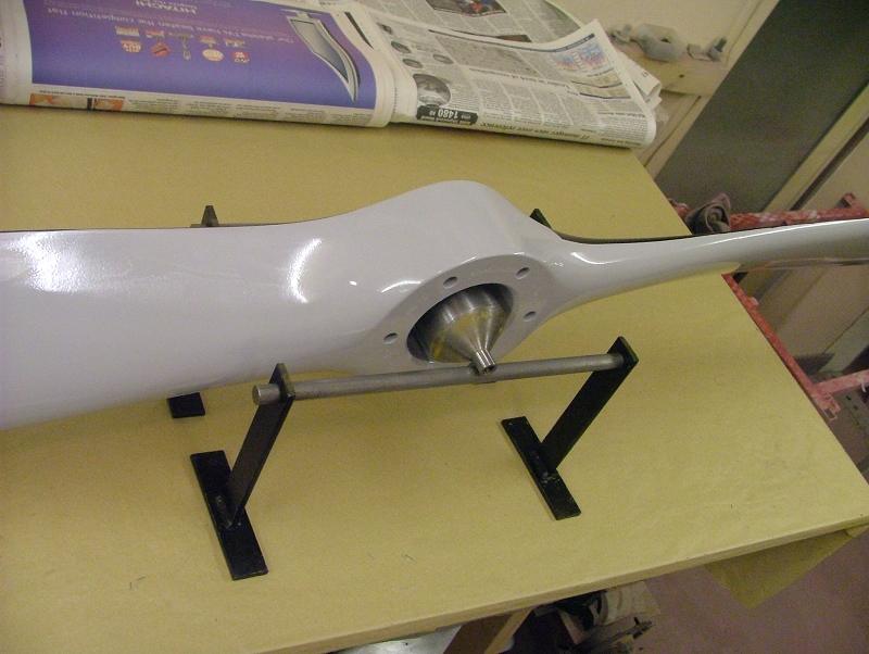

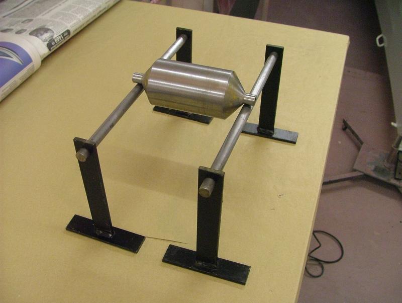

      Here's what is meant by knife edges (although in my case they're round bars). The principle is to keep friction to the minimum to allow the prop to rotate to show out-of-balance.

              Re: Prop varnish and balance
              Robert,
              That rig looks pretty high tech!
              HT
                  Rob,
                  That is a nice looking coating you got there. What type of paint did you use?
                  Andy
                      Originally posted by rotaxflyer View Post
                      Rob,
                      Andy
                      After alodyning, it's two-pack etch prime, then in short order a very thin coat of epoxy 2-pack primer, cured for 7 days, then sanded then 2-pack acrylic top coat.
                      Tough as old boots.
