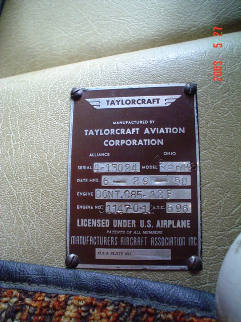

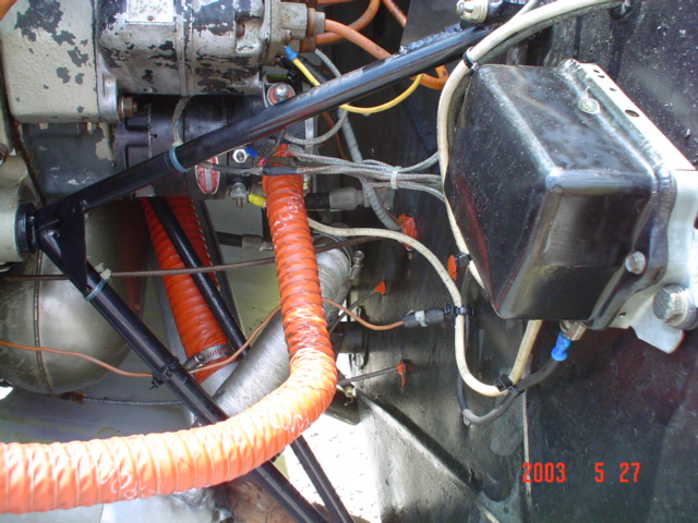

                    You may want to check BEFORE u buy.
                    We have a "Harer" (BC-12D) conversion here with a 90 hp.
                    It also incorporates a C-150 exhaust system.
                    All was done long ago via 337.
                    It appears the sump is either a left or reversed unit.
                    In either case it is short.
                    Otherwise it is impossible to remove dipstick as it hits exhaust.

                        There is at least 1 that will reverse. Looks like it may have been reworked.
                        When filler is turned to the right the C-150 exhaust interferes with
                        dipstick removal.
