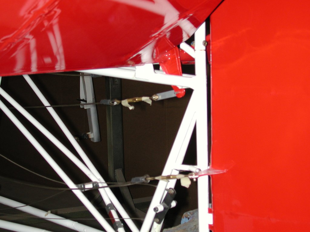

          But are the control horns the same? On my pre-war airplane there is no room between the control horns for the servo-tab jack-screw pulley.

            Distance between the horns is unchanged between prewar and post war. Jack screw sets behind horn and the pulley is the only thing between. Something I have thought about but have never tried is adapting a L-2 trim system. You would have to modify the elevator of course, bolt on exterior pulley sets, and depending on routing, and still use the cables but may require a new handle to allow more tab travel.

                This isn't true for my airplane. There is no room for the jackscrew. I'm not familiar with the L2 system. Could someone post a drawing.
                Otherwise, electric trim seems like the simplest retrofit. (heresy I'm sure!)

                  It still fits nothing dimensionally is different. When you change the left elevator for one with a tab, you would also need to change the right elevator for one with a hole to clear the jack screw.
