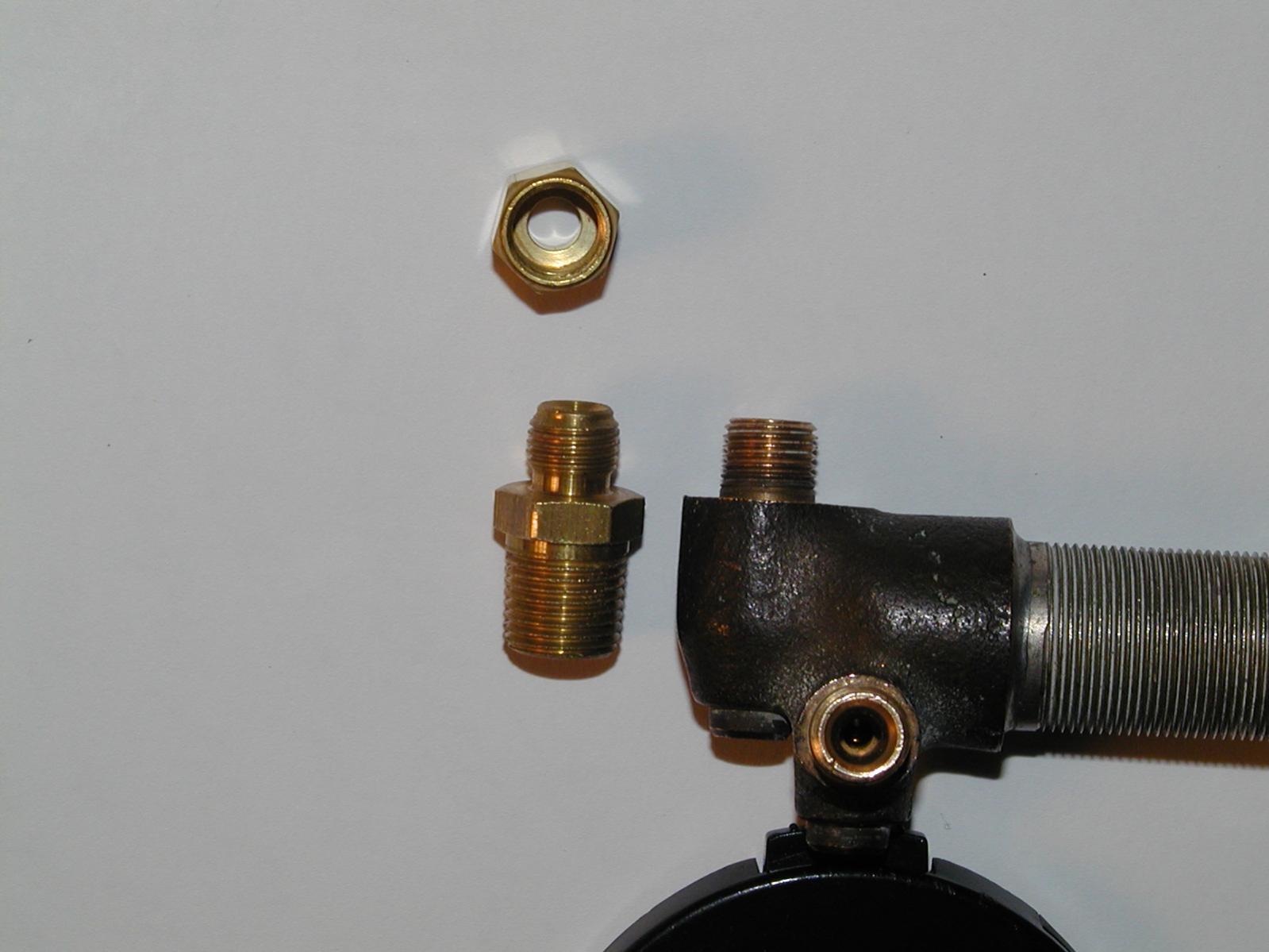

                  Does anyone have an idea what the pitch/thread is on the inlet/outlet of the Lunkenheimer primer? Or better yet a part number? It is not 5/16-32 as is pictured beside it. Notice that the threads are slightly tapered, I believe it is metric? Thanks, Jim

                    Re: Lunkenheimer Primer
                    I would say it is metric thread. The name sounds like German to me, and they definetely use metric threads and measurements. Marv
                      Jim- I have a Lunkenheimer calalog from the late 1920's and it shows a 5/16-32 USF thread on the primer. This is the same thread for the 1/8" primer line and nuts you can get at a/c spruce.
                        Pipetread most likly 1/8 pipe tread it it is tapered.
                        Pipe is measured by the ID of the pipe in schedual 80 and therefore the pipetread is about 3/8" in diameter or as the book specs say:At the end of the pipe and tread .36351" at the inner end of thread 0.3840"
                        witha 27 threads per inch pitch.
                        There is also a 1/16 " pipetread very rare but I seen it in some smaller fittings and as pluggs in hydrualic valves. small OD is 0.27118 " and large innner end is is 0.29044".
                        Note what a pipe tread is always taperd and if you tighten it to hard it will expand the part it enters into and can/will crack it!
                        A good sealer is needed for the gasoline! NOT teflon tape!
