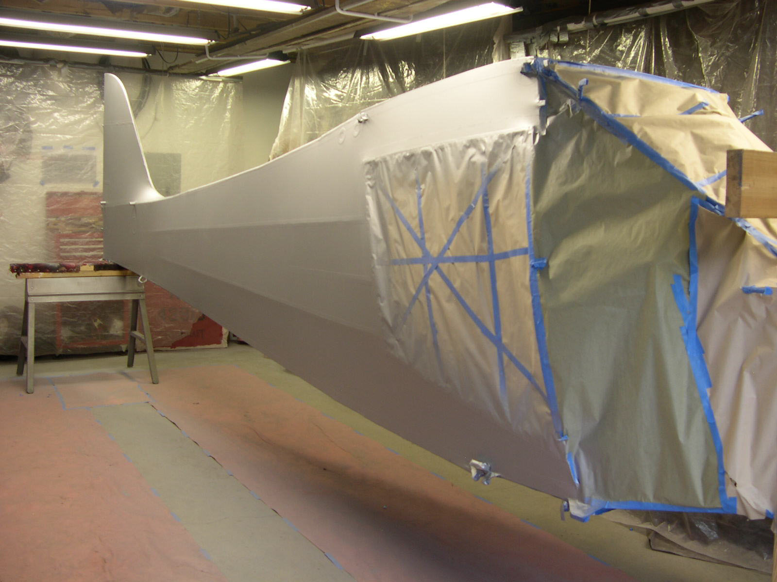

    I completed the silver coats yesterday. It took 6 gallons of PolySpray to do the entire plane with 3 coats of silver, (4 coats in some places where I over sanded.)
    Next up: a coat of white, then 3 coats of red and then finally black trim. If I don't screw up at this point I'll have the cover job completed early next week. Yipee!

    Looks great Bob. What type of spray system did you use? HVLP or reguler presure system. When you get this far, you really get motivated dont you !! Keep the pic. coming so the rest of us will be inspiered . Carlton

        I'm using a Devilbiss StartingLine HVLP gun ($110 on eBay for a two gun, 3 tip kit). It connects to my regular air compressor. Good outfit, it gives a nice finish with very little overspray.
