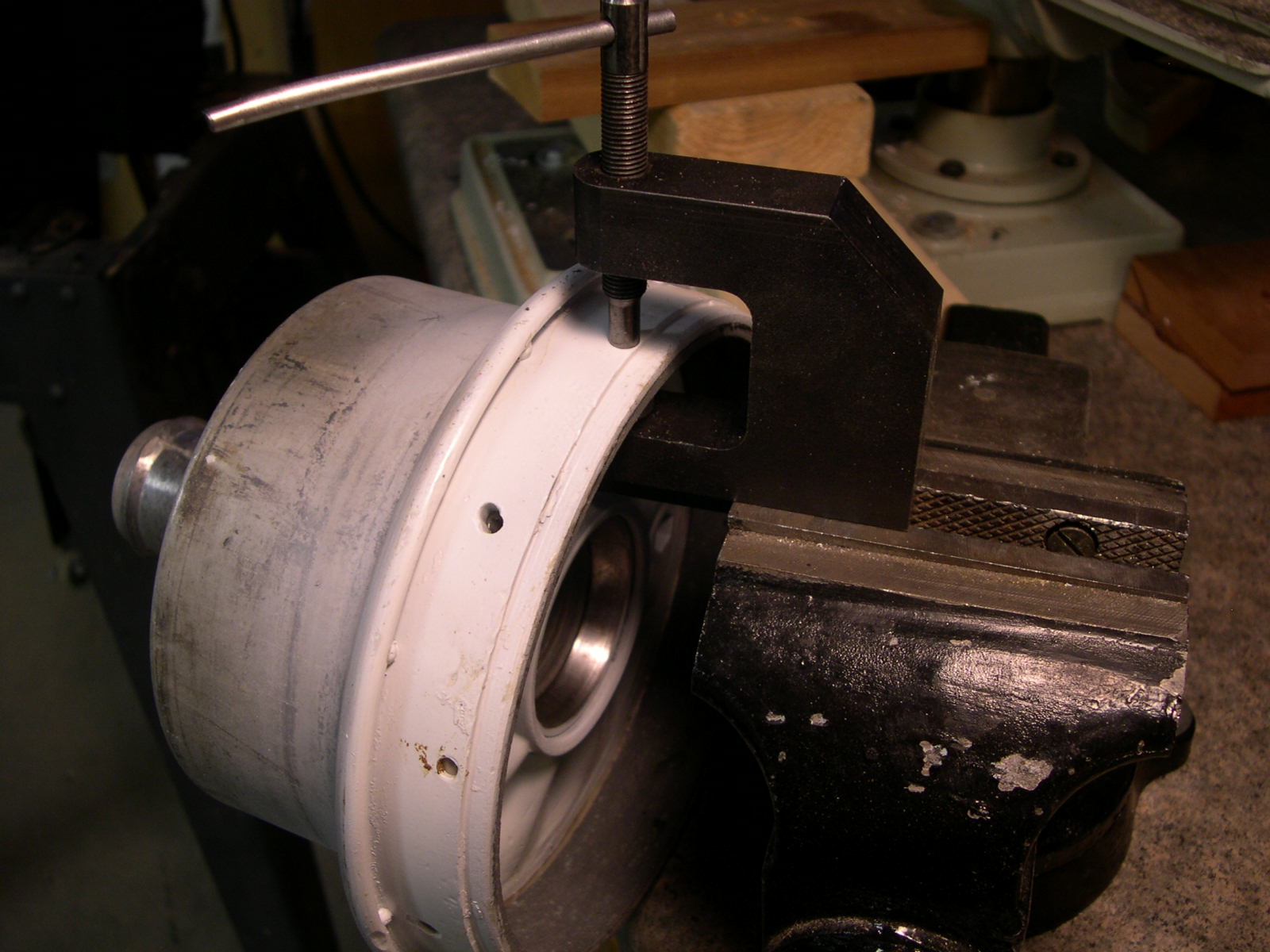

    Where do you get the tool to squeeze the rivets when replacing the brake linings? Anyone have a picture of the tool?
    Re: Brake Rivet Tool
    There are a number of options I suppose. I bought one from Aircraft Spruce at Airventure a few years ago. Here's their link:
    Deflate the tire for tool clearance and you can leave them on the wheel.

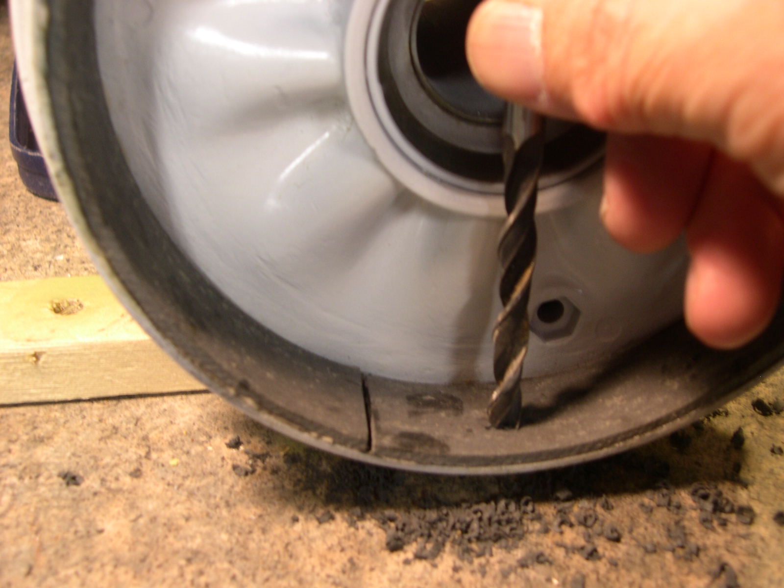

      Just be careful when you countersink the rivet holes. It is real easy to go to deep.
        I'll second that "careful when you countersink" The lining material is very soft. You can actually countersink easily by hand. I used a brad point drill bit. It makes a nice flat bottom countersink. Turning the drill bit by hand and checking the depth often assures you don't go too deep.
