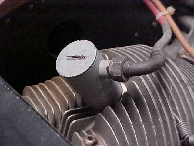

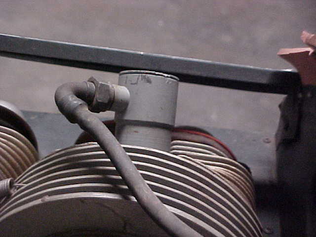

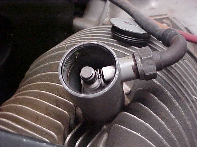

              I don't want to violate any decency rules on the forum, but does anybody have a picture of one of these "cans?"
              Seriously-- I've been trying to visualize what an Ercoupe can looks like and what the thread mod for TC is like. Is there a wire that goes from the plug to the can to the harness?

                Re: spark plugs
                I thought I was going to have to use these cans, so I did the research a few years ago. These pictures were part of my collection.

                  Thanks, Richard. I appreciate the effort!
                  Sure don't much like that connection to the plug conductor!! Did standard short, shielded plugs end up working for you?

                    Re: spark plugs
                    I've been using similar cans on the 12D I have now for at least 200 hours with no trouble from them, including the sideways spring connector. You will hear rumors/concern of sparking to the case and such, but I have never had it happen to me. Maybe if you had a 1/4 inch gap on the sparkplug, chuckle. High voltage always takes the easiest route (usually read as: shortest.)
                    Main problem is they aren't able to suppress the big RF signal generated by the non-resistor plugs when they fire. They are therefore still noisy.
                    For radio quiet you need resistor plug + Shield.
                    Just thought I would warn you, having done the whole bit myself.
