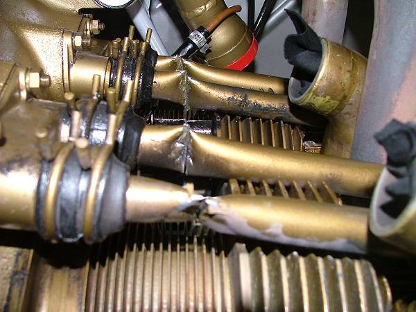

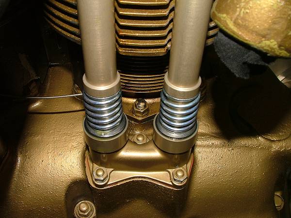

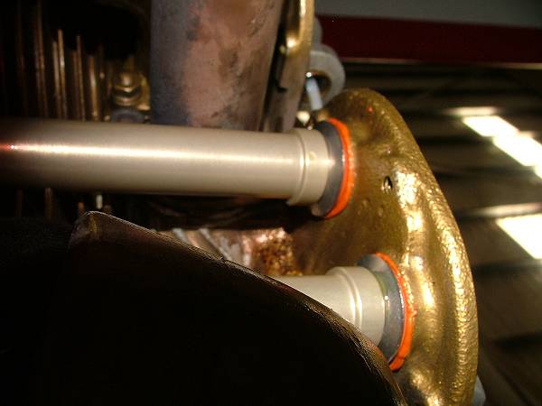

            I used a swaging tool to re-swage the steel push rod tubes into the aluminium head, but after so many goes, I got fed up with the continuing weeps.
            So I bought the push rod tube conversion kit and installed it. No more leaks! There is no need to remove the cylinders. Don't forget to remove the push rods before cutting the old tubes out! And don't use a hacksaw (the filings could get into the engine...use big bolt croppers).
              Re: Oil Leaks (was picture of the week hijacked thread)
              Thanks, Robert. That's a nice, tidy looking seal and it makes more sense than swaging into the head.
              Yikes. No kidding! I guess you're pretty much committed after picture #1.
                What they don't tell you in the kit is that you need the spring compressor to compress those nice looking springs (naughty of them).
                You need to purchase the compressor (I bought two, just to be sure).
                  Squeeze the spring in a vice (whatever you call it on your side of the pond) so that part of the spring sticks out of the vice, one wrap of safety wire, rotate 180 degrees, any other wrap of safety wire, so the wire is holding the spring collapsed. take out, put spring on tube, insert where it belongs, then pull off the safety wires. No need for their compressor. Happy Easter to all, O. T.
