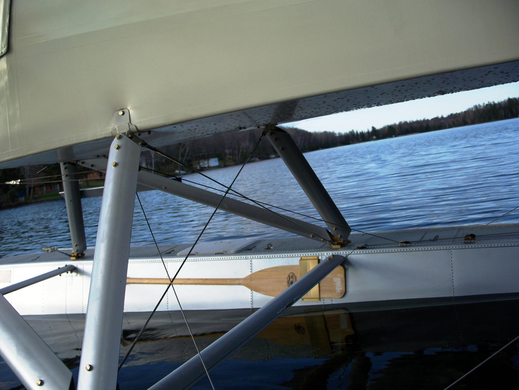

Ward, This isn't my plane, but this pix from "wlas" at Wolf Lake, shows the same type of weld-on I have. Open the page and scroll down to the yellow plane pix:

Here's the bolt on that Baumann sellsAttached Files
