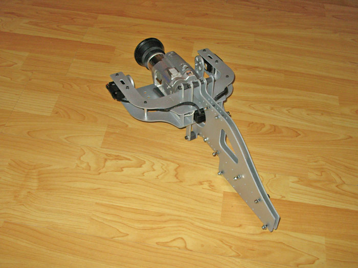

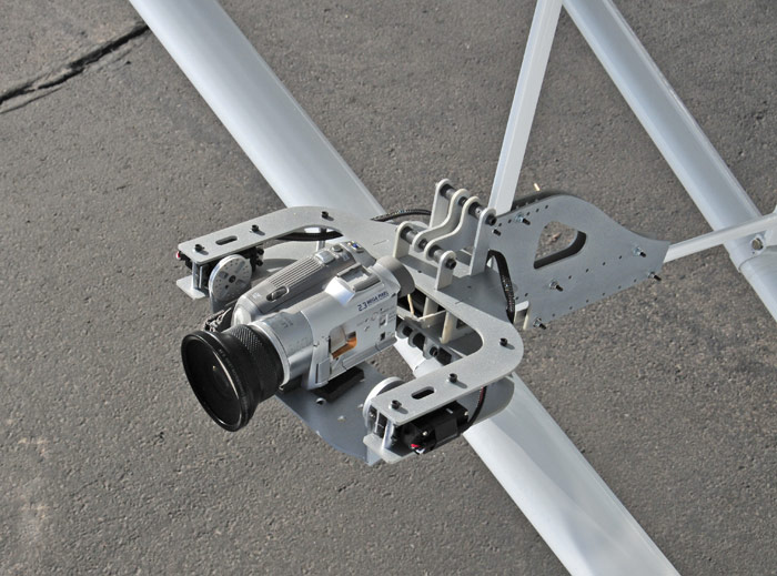

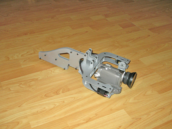

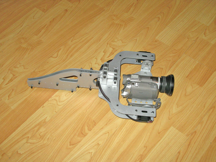

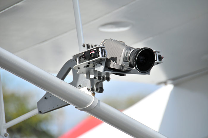

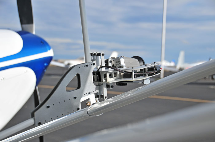

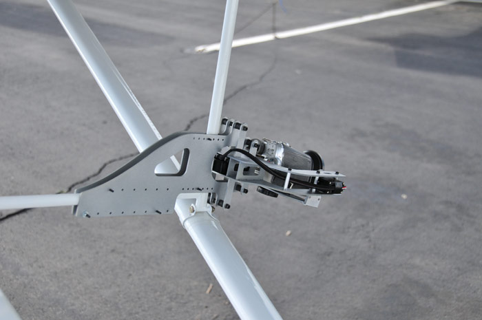

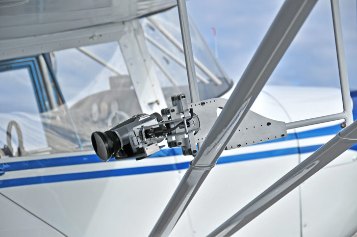

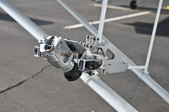

    Been working on a jury strut mounted camera gimbal. Currently only with a tilt axis, but eventually tilt, roll, and pan with IMU stabilization.
    Dual high torque digital servos drive the camera plate in tilt axis. The lower camera plate is adjustable up/down & fore/aft to align the tilt axis with the CG of the camera. The U-shaped gimbal is isolated from the main frame with neoprene vibration isolators. The whole system mounts up to the jury strut where the jury struts meet the main lift strut. NO HOLES to be drilled. Slips over the jury struts. Can be mounted to the front or rear for forward or rearward facing shots. CNC cut from G10-FR4 fiberglass composite and aluminum.
    Weight with a HD video or still camera is approx. 2.75lb
    Now... let me say this. (ah-hem... clearing throat) This is for "Experimental" certificated airplanes only if you know what I mean. Never to be flown on a Standard category airplane.
    Now that I got that out of the way... more pics of it mounted to the plane and some aerial HD video soon to come.

    That's GREAT ! Fantastic.

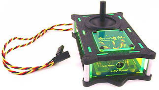

    If you have not already thought of this, I suggest that you have an in-cockpit controller that uses an R/C transmitter joystick to move the camera.
    If you mount the joystick in the cockpit keyed directionally to the mounting on the jury strut, then you can simply point the stick from inside the airplane and know that the camera is pointing the same direction relative to the airplane...

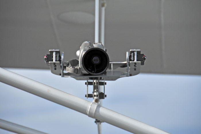

      yes... hard to see in the photos but there is a Futaba receiver in there. For now it will control only tilt axis of the gimbal and shutter trigger/start stop record. I also will have a 2.4ghz microwave video transmitter to a LCD display in the cockpit.
      In the future full 3 axis pan/tilt/roll/zoom/shutter will be supported.
      To make it even less expensive it could be configured with a cheap wired joystick into the cabin. Just tape the wire to the strut and bring it inside the door.

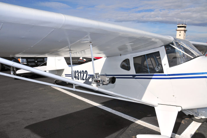

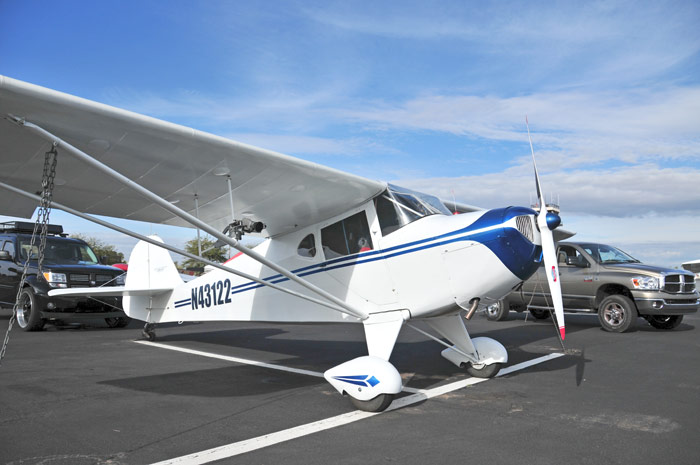

      I took some shots with it mounted this afternoon

          Also forgot to mention that while I was at the airport I tried the gimbal on a C-140 and a Super Cub and it fit the jury struts on those as well. Seems to be somewhat universal. I'd like to make a lift strut clamping version for airplanes without jury struts.
          Hmm.... time to pull out some Delrin and get the CNC moving.

              That's exactly what I was thinking. Being able to use your orientation/position seated in the airplane as your aiming reference and having the camera position tied in with that, as opposed to having to look through a viewfinder or monitor while flying. I'd use the gimbal/stick assembly removed from an R/C transmitter for helicopters, because it has the movable knob on top of the stick. You could hook up 3 axis control with one joystick.
              Now if you really want to get fancy, you can hook this up to a head-mounted sensor like the military, where the camera pans ans swivels to follow your head movements. A button on the control yoke to start/stop recording too. You might even put the U-2 people out of business
                Re: strut mounted camera gimbal
                as it happens for a $150 you can buy a small head mounted unit that will send the signals to the servos. it works exactly like an Apache gun mount. Wherever you look the servos will follow.
                With a monocle or video glasses and that headband it is entirely possible. it amazing what can be easily built these days with off the shelf components.

                  I positive now that it does not need dual servo drive. A single high torque servo will work fine.
                  Also I'm going to move the location of a few of the vibration isolators to help remove a resonance I am experiencing at certain power settings
