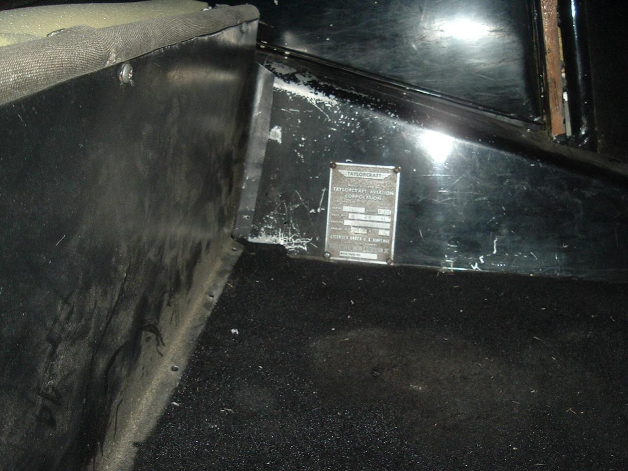

    New to this forum and seeking advice. I'm a Canadian aircraft mechanic and trying to sign out a BC-65 after some work was done on it and would like to see the manufacturer's data plate. We've look all over but found nothing. Does anyone know where it should be mounted? If we can't find it is a replacement available from Taylorcraft?
    Re: data plate
    Mine is on a sheet metal panel under the lower left side door sill. It is a removable piece of the interior. I will try to locate a picture of it. 1946 BC12D.
    My Father-in-Law's '39 BC-65 data plate is located on a similar vertical wood panel under the seat facing forward.
