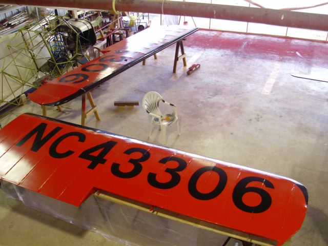

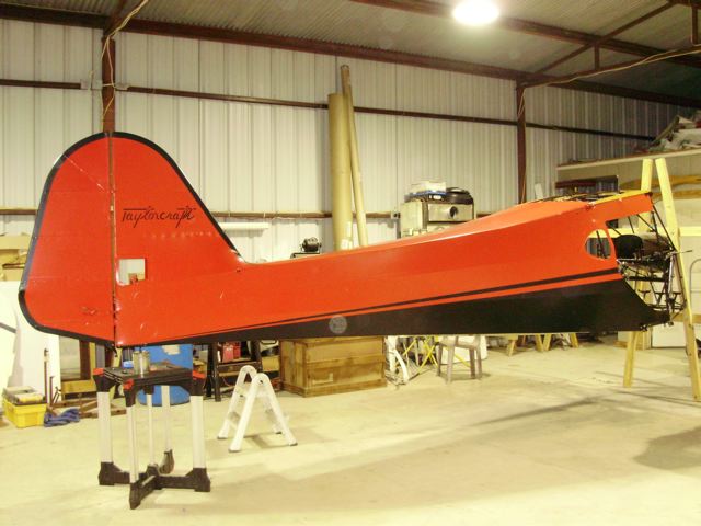

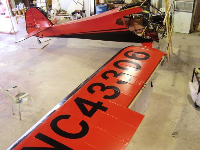

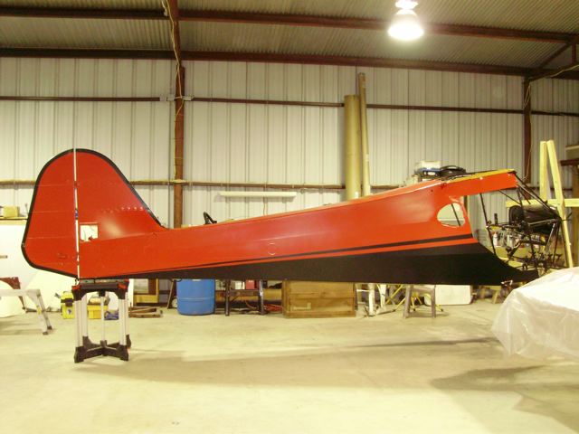

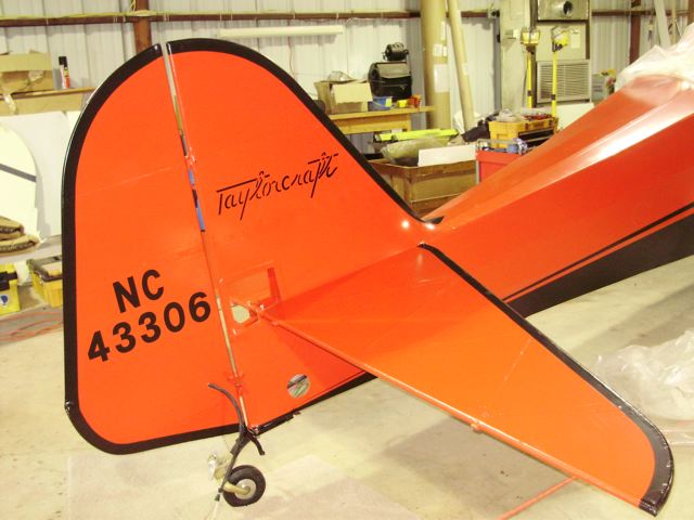

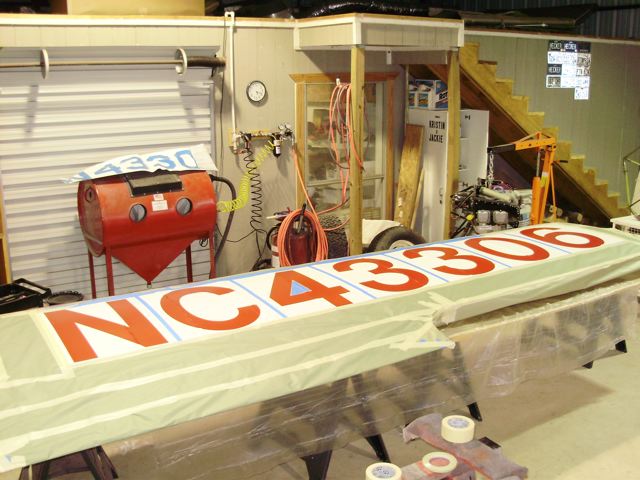

      Thanks for your note...and good advice. I am attaching some photos taken by Mark Julicher today. Some control cables were replaced today, and we are beginning to start firewall forward. Doc

        Re: Aerographics "Gerber" mask
        Hi Doc
        That sure is looking great--the two-tone paint,rudder trim, and large numbers really give it a classic antique look. When it's, finished you and Mark
        need to fly it over to San Marcos sometime.
        Buell
        Buell Powell TF#476
        1941 BC12-65 NC29748
        1946 Fairchild 24 NC81330
          Thanks Buell. The tail numbers were the 3-7/8" you recommended after our last telephone call. You can see we put them where they would fit - they look nice. Just ahead of the dorsal fin is a "spade", which I am calling the tip of the Draggin' Dragon's tail curled around the tail. My wife nixed the name of "Dragon Lady", so I have a working name of the "Red Dragon" Doc
