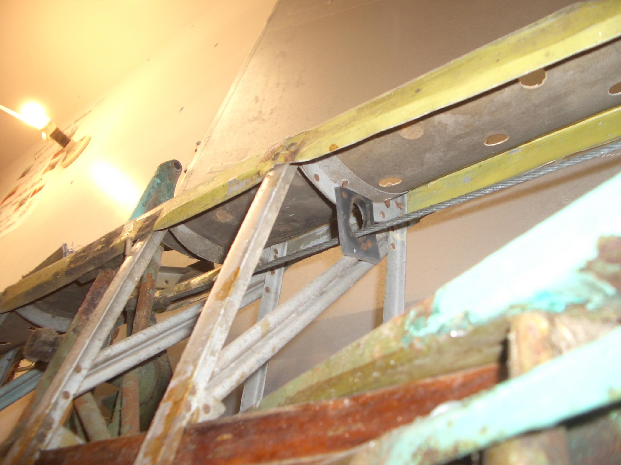

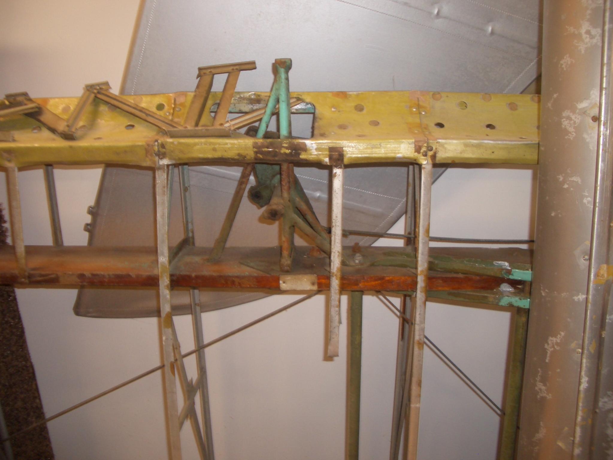

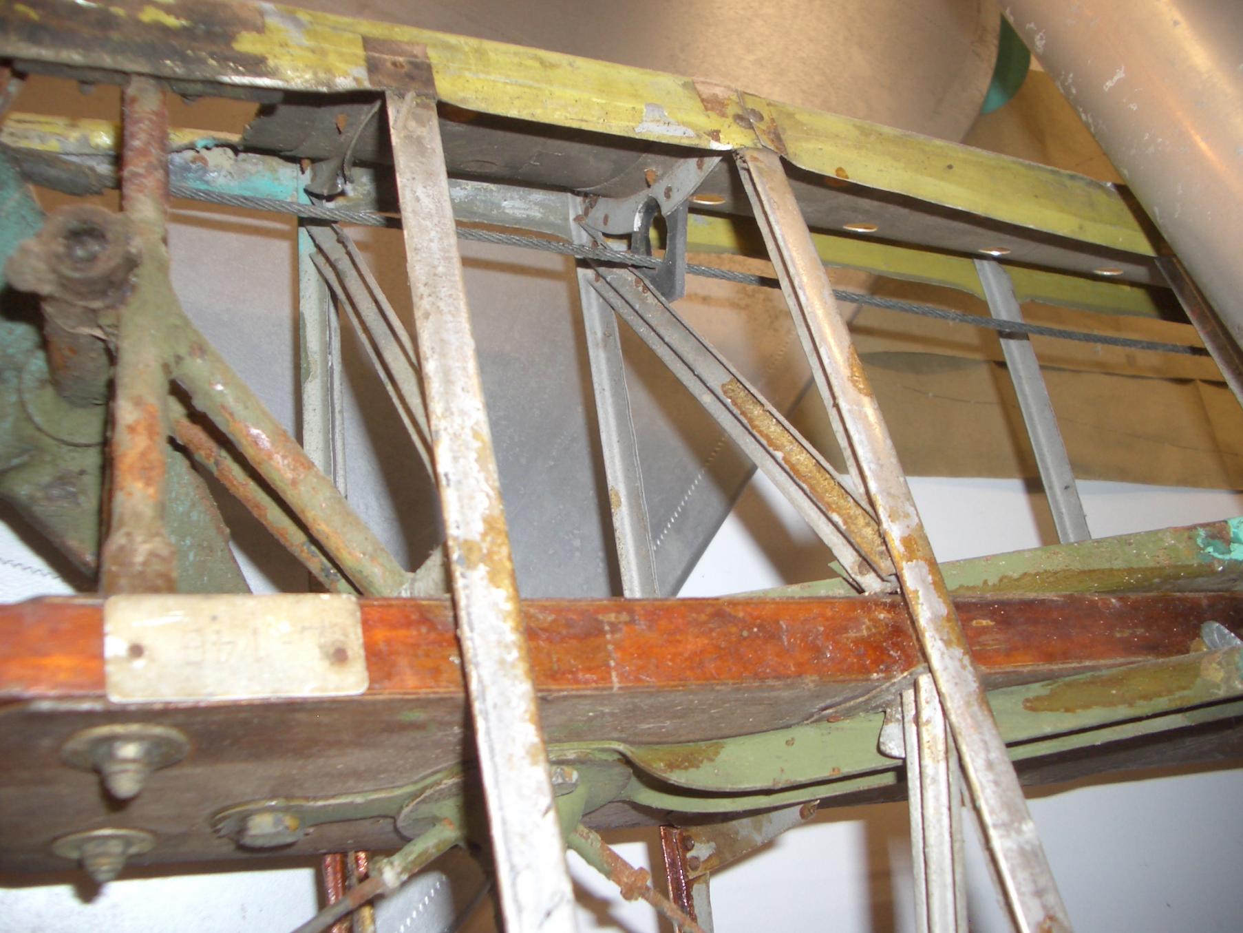

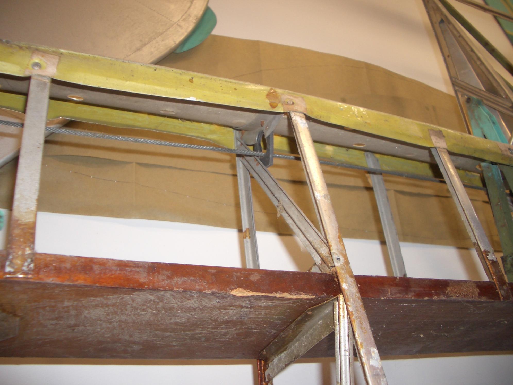

                D you have access to a camera? We made a mistake last night, and mixed our spare & original ribs. Now, we've gotten them all sorted back out - except ribs 9-14. We know 9 & 10 have the bakelite guide for the control cable, but some of these ribs have a rear end curve twice as wide as others. Which ones need that double-wide curved metal rear? Can we substitute one of them any place it calls for a single-wide rib?
                Every single photo the prior owner took that could have answered this question still had the aileron cove in place, hiding the information we needed. I will not cry, I will not... I'm just going to ask for help.

                  Dot I will look and take pics tonightas I have the 15 rib wing too. I have one wing still completely assembled without covering just for this kind of thing.
                  Larry

                      Here are some pics if I have done it right. The outboard rib by the aileron linkage is the one with the double width. Pic number three is the one closer to the root. You will see that two cove sheet metal pieces attach (come together) there. If these files are too big, let me know and I will shrink them. Larry
