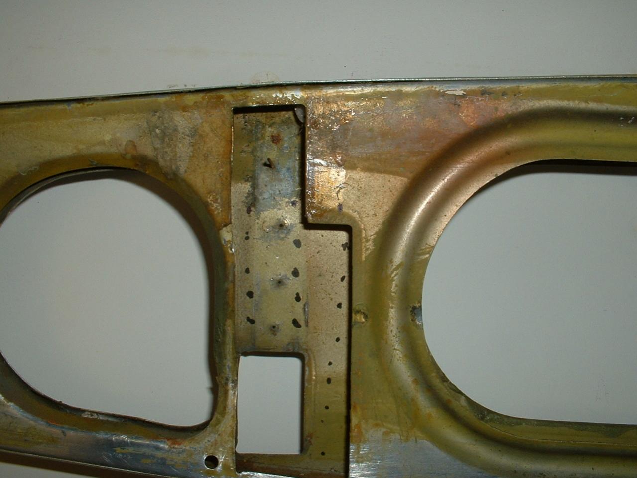

So, back to my rib repair. Lots of valuable suggestions on how to repair the ripped web from the group, but the final judge is my IA, so I visited him at noon yesterday. He looked at the rib.
He turned over the rib. (first picture)
He pointed out the cavity thru which I could work and he described a very simple patch (template shown in second picture)
which he would allow to be held in place with 2 1/2 rows of CherryMax rivets (since I have solid rivets and my gun is a day or two away from arriving, I think I'll stick with solid rivets). The dotted lines are where the rivets will go; I plan on substituting aluminium sheet for the 3x5 card stock.
