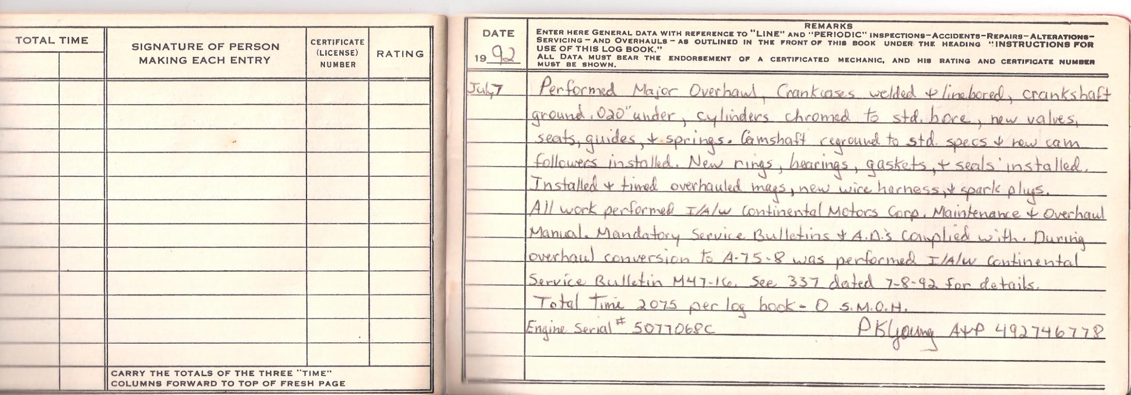

                My cd is on the way from the faa with the 337 but the picture is a copy of my logbook entry. N43524
