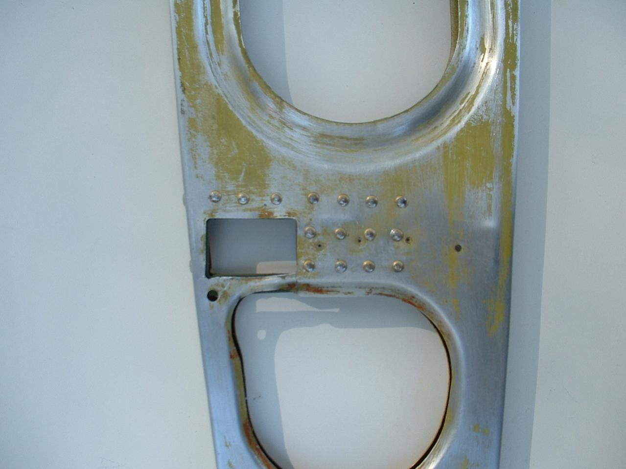

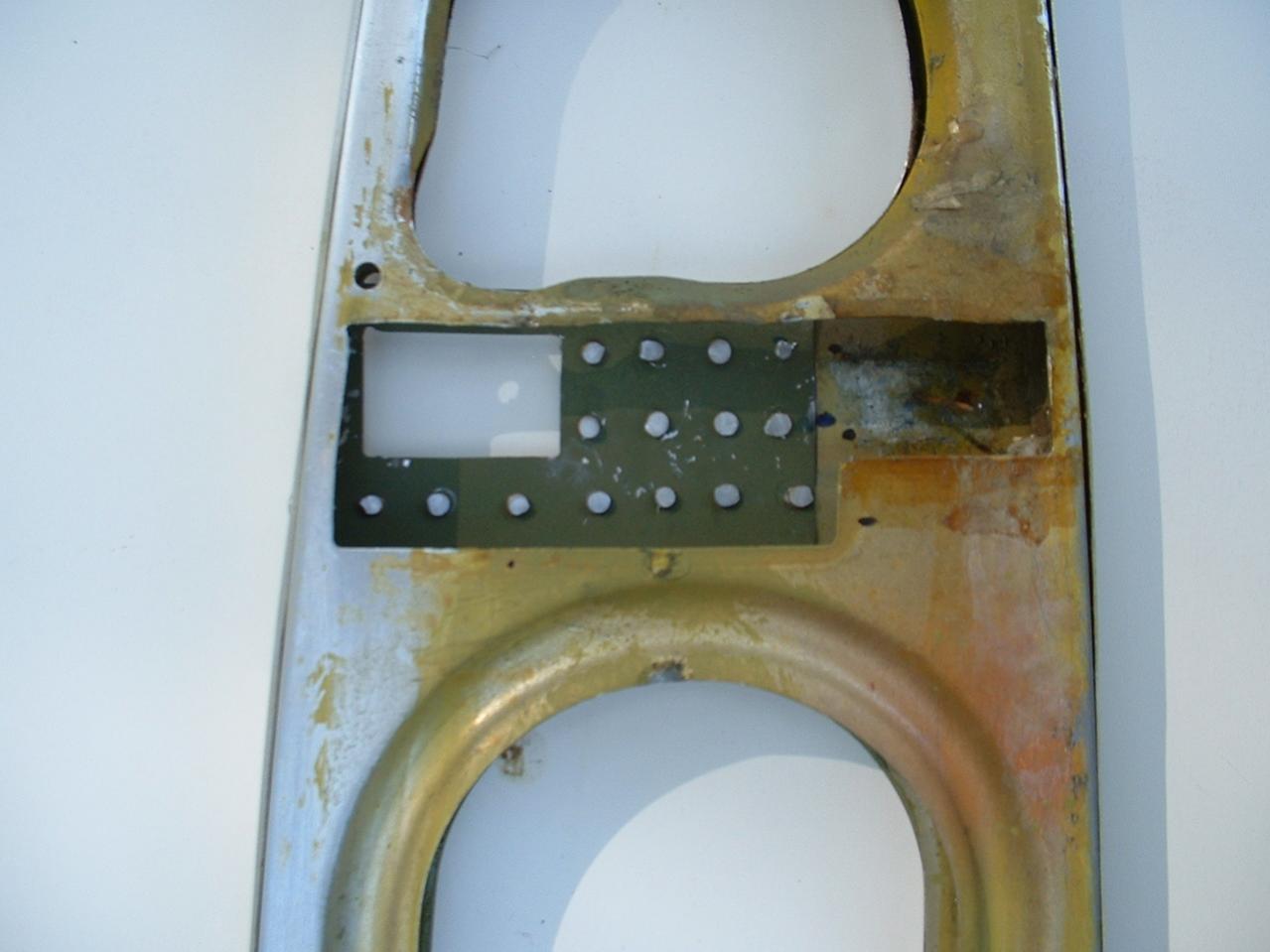

            For those of you who may be pondering the question "what ever becomes of all these questions?", attached are pics of the end results. Thanks to everyone for their input. Now on to the next adventure - MikeH

              Nice repair Mike!
