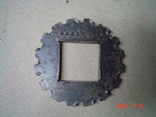

              I leave the adapter in place. Special tool attached to this message to remove screen very easily. Remove oil temp probe , place over screen
              1 in nut and smack with a drift punch .
