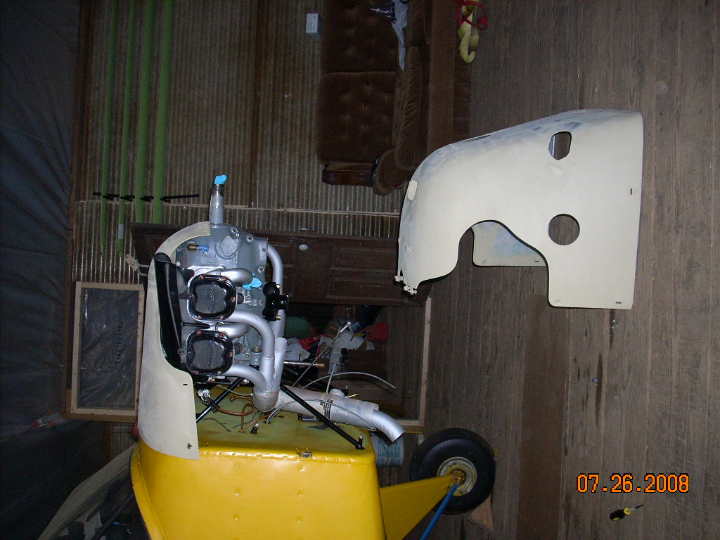

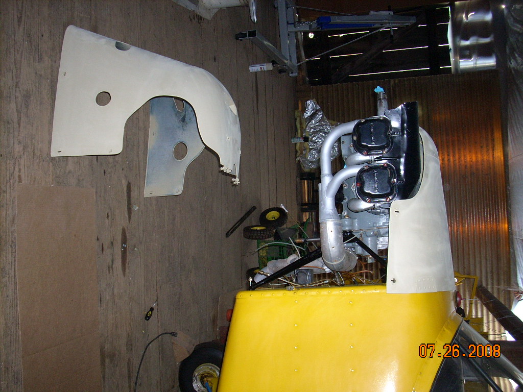

Is there an STC for the Hanlon Wilson or Luscombe exhaust system for a B model? I'd hate to put another hole in this Lyc. cowl. I'd trade my very nice standard exhaust for an approved split system......

Hi Richard, Yeah I think I saw that over in the tech section. It was part of the Lyc. to Cont. switch. Just a one liner with a reference to a dwg. I agree with you on the weight. Still trying figure out how to run the cables and fuel lines around the standard exh. Oh, and pricing a new H-W set from Wag Aero $1600+!!!!20442
