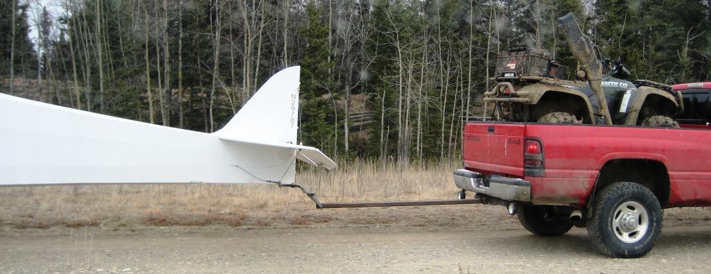

    I towed my airplane back to the airport, check out my home made tow bar....
    Its just 2" 1/4 wall square tubing....Tim

      What are the considerations for the towbar length?

        Longer than the horizontal is wide! That way you can do sharp turns. Tim

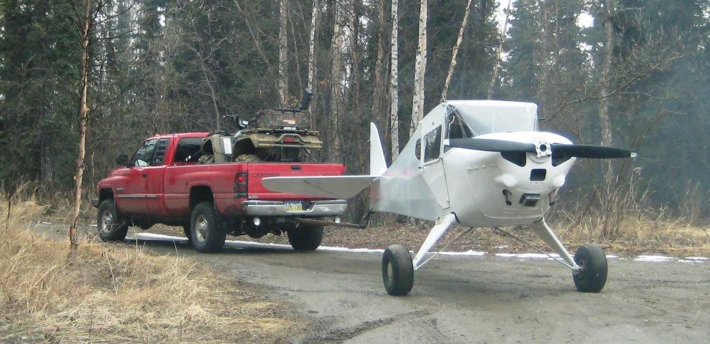

          Just make sure your doors are shut real well and secured, or even better yet, removed completely. I saw a guy tow a homebuilt like that one time and at about 20mph, the door came open when he hit a little bump....sure didn't make his day!! Good to see yours headed to the airport, Tim!

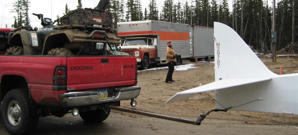

              If you're on the open highway, did you need a permit of sorts? - MIke

                Probably an oversize load sign but I was only going 3 miles and to get a permit was probably 360 miles away, so I risked it....we dont have a local government here, no county/bourough, and no city police or taxes....Tim

                  I saw a guy tow a Tcraft this way from Michigan to Georgia. I would have bet money he'd have burned up the wheel bearings,but everything worked fine. He duct taped the doors shut,loaded the wings on a home made rack made out of 2x2s & away he went. I bet he got a lot of stares going down the highway.:clue?::

                    Congratulations on reaching a major milestone. What kind of exhaust system do you have? It looks like the angles on the end of the pipes are facing forward. You didn't put them on the wrong side did you? There was a Taylorcraft at the Columbia Fly-In LAST year that had Luscomb exhaust that were installed on the wrong side. The angles faced forward like yours in the picture.
                      Re: Tow bar for the long haul...
                      I have Chief mufflers. and they are supposed to point foreward. If you look at ano older 170/172 with the O-300, they also point foreward. It has to do with the power pulse pushing the exhaust out farther from the airframe. Now I just have to get my wings figured out, they keep getting busted up from the wind storms around here. Hopefully about 2-3 weeks to flying. Thanks Tim

                              we towed ours this way this morning. Only had to drive about 1.5 miles. Used a 5' long 1/4" wall steel tube. No need to remove the tail feathers. plenty of turn radius room.
                              Had my 14yr old son sit in the plane during the ride to keep the doors from flying open. he liked that.
