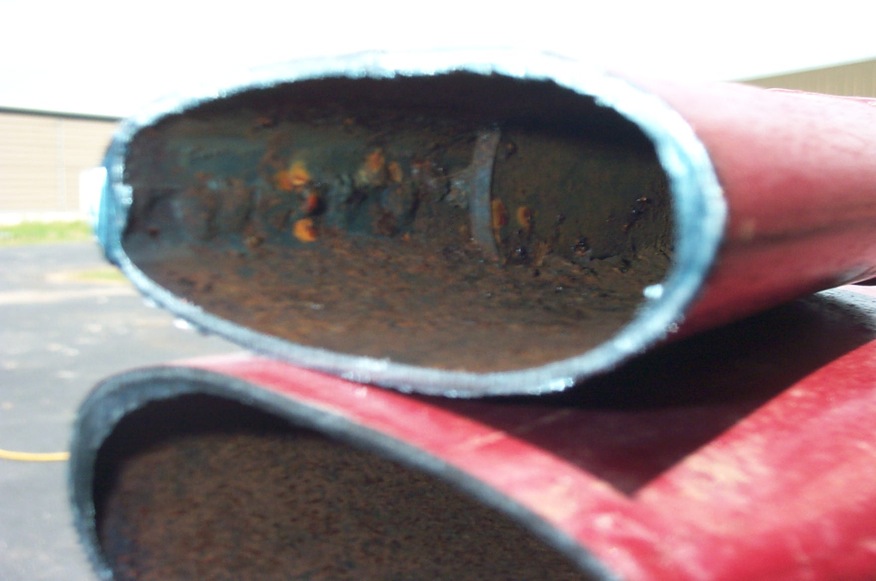

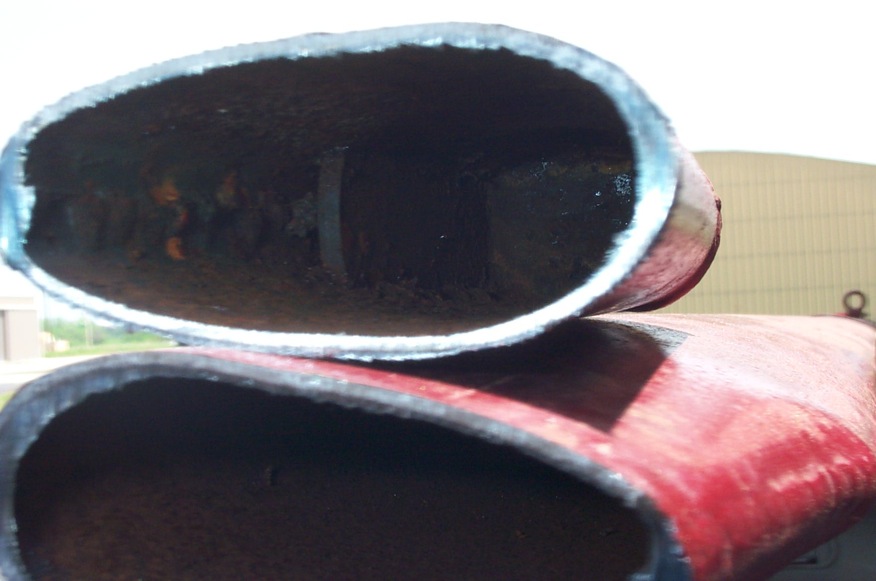

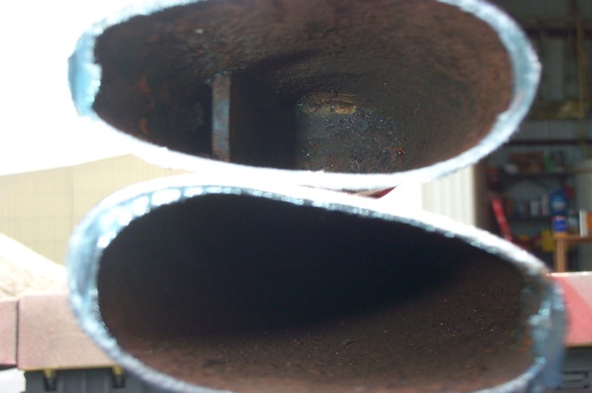

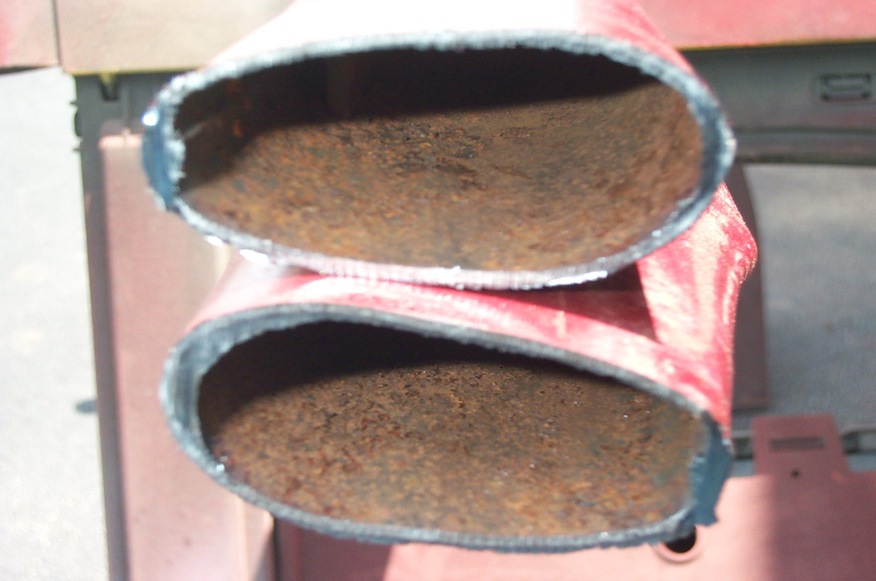

    This was my front left strut. Four photos from slightly different angles. There is slight pitting and a fair amount of surface rust.
    My struts were rejected based on the x-rays, with the inspection station telling me they would not bother to do ultrasound 'because they are in such bad shape.'
    Aircraft history: It was in a barn from 1980 to 1985 when I bought it. I doubt if it was hangared much before that. I restored it in 1986 and kept it tied down out doors in Arkansas, and Illinois for seven years. It was in a hail shed in Dayton, Ohio from 1993 through 1995. Moved to a hail shed in Ft Worth from 1995 to 1997. Tied down out doors in Arkansas from 1997 to 1999. Rebuilt in Marietta, Georgia in 2000. Tied down out doors at Cartersville, Georgia from 2000 to 2002. Kept in a hail shed in San Antonio from 2003 to present.
    In all that time I never put tube oil in these struts. Call that ignorance or neglect if you wish. The plane was out doors through many gully-washers, brutal Arkansas humidity, and even a hurricane.
    There is plenty of metal left. This strut is not pristine, but it was perfectly safe. A bit of oil and it would probably never rust again, but I have four new struts now.

      I agree,your struts are ok for now,but I still see a couple of heavier rust spots in those pics and it would not have been much longer until those struts became a problem. Look at it this way,if the AD had not came out,would you have questioned those struts? You would have probably flown them another 10-20 years without question,treatment,or worry and from the looks of a couple of those spots in your strut it would NOT have lasted another 10 years. That is one of the reasons we have the AD, so we inspect or replace them BEFORE they break! I know the FAA went about this AD the wrong way.They should have given us a little more time to adjust and comply,but they didn't. You are seeing this lightly to moderately rusted strut as a question of "why did we need this AD?" ,but for most this picture show's us and your story tells us exactly why we need this AD. Agreed that if the strut had been treated with something 20 years ago it would probably be rust free today,but it wasn't. In fact,the struts that had been treated at least once in thier life is probably the ones that are passing the AD while the untreated ones are not. I don't mean to offend you on this but I'm just saying this the way I see it.

            Your analysis is right on. There are some rusty spots that would be better off fixed. Some of the spots that look like heavy rust are actually welding beads with surface rust on them. Still, you are looking inside a 62 year old structure and it isn't too bad.
            I also cut one aft strut and I'll send both cut pieces to any responsible party that wants them. I will probably cut my other struts just to be sure they stay unused.
