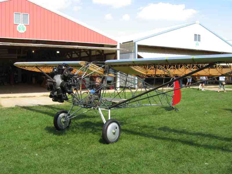

        There was a pic posted here awhile back of a taylorcraft being built at Broadhead with a LeBlonde on it. Cool as hell.
          Re: Radial Powered Taylorcraft Model A ?
          Here are the pics

            If memory serves, I thought it was a Lambert R-266 .
                  I love that thing! Except the Lambert scares me. a ticking time bomb they are.
                    Here are the pics
                    I like that.........a lot!
                            Here are the pics
                            Hard to tell, but that looks like a Warner to me. Notice the case bolts between the cylinders. What do you think?
