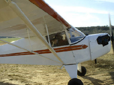

      Thanks Terry those pics are just what I needed! Are you saying that I could have modified my Lyc cowl to fit the Cont????? ops:

        A few years ago I changed one from a Lycoming to a Continental. I re-used the nose bowls, and made new flat pieces. It was about a day job. Tom

            As we discussed the nose pieces can fit, Lyc has a small hole , The older Exhaust was two piece up stack for the 50HP ; I have an A-50 up stack engine & exhaust here for sale...... e-mail [email protected]
