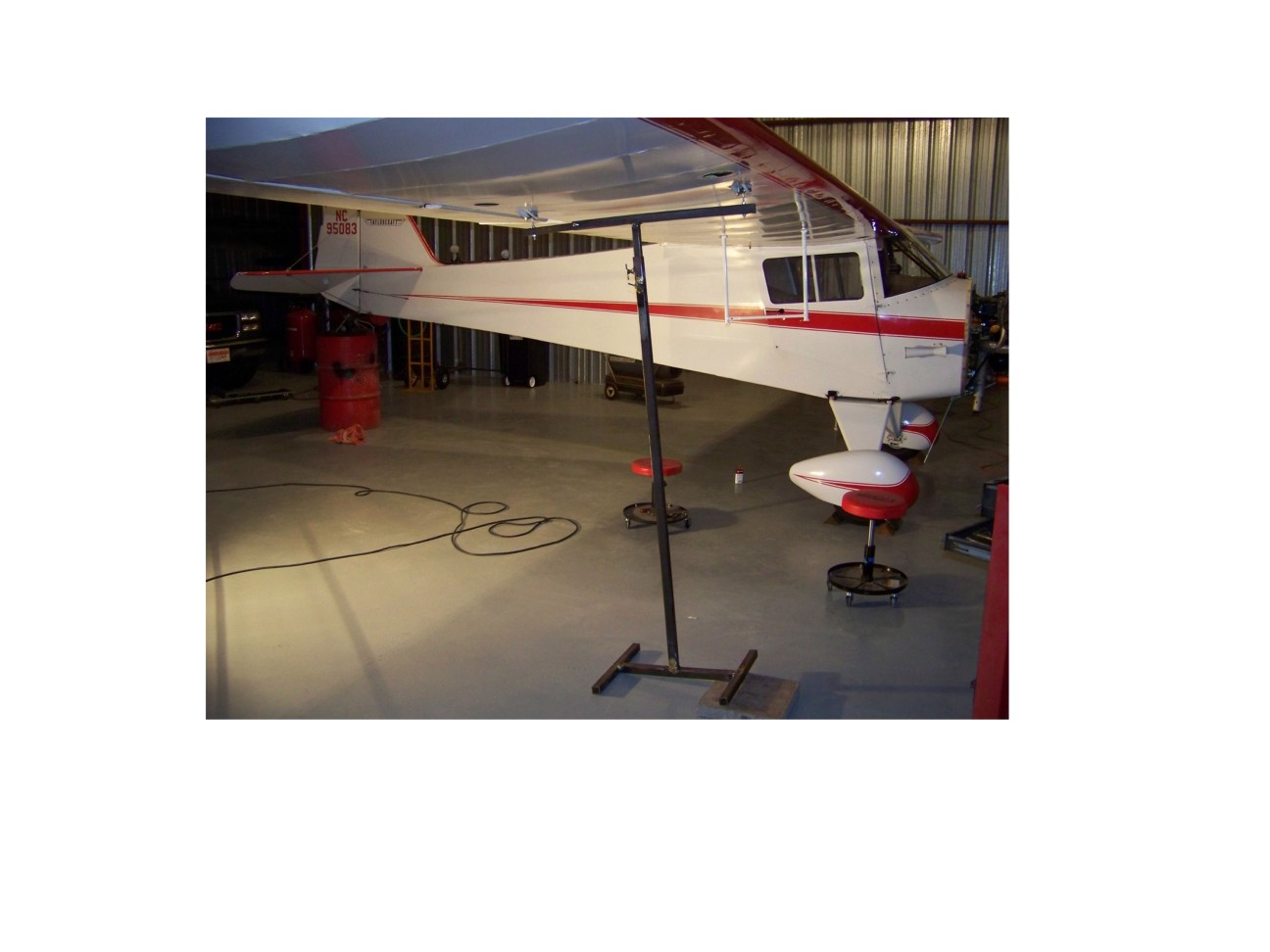

                This is simular to Garrys, deal, I used his idea and expanded it alittle, this
                one is out of square tubing, and is adjustable, also used hardware from
                local COOP, eyebolts were 1/4 in, and I welded a cross tab so that the
                bolt would not protrude up into fabric above the strut attach point
                JS
                  Re: Wing Support?
                  I could spend time hanging out in your hangar!
                  nice plane ,nice hangar,not much more to ask of a hobby than that!
                    Re: Wing Support?
                    Thanks for the pix and ideas. Nice plane, sure looks good with the wheel pants.
                    Darryl
