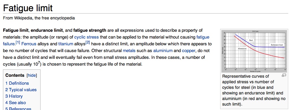

      As to the question of which type materials are subject to fatigue cracking or hardening and then cracking, I have copied a bit out of a Wikipedia article on the subject. See below. In a nutshell, metals fall into two categories: Those which eventually fail if repeatedly stressed even a small amount, and those which do not fail providing you don't stress them beyond their "endurance limit". Copper definitely falls into the first category, while steel falls into the second category. That's one of the reasons you see springs made of steel but not copper or aluminum.
      Can you make copper lines last a long time ? Yes. The trick is to immobilize them so that they are not flexing at all. Lots of support clamps so they don't vibrate even a little bit. But with steel, the worry is reduced immeasurably.
