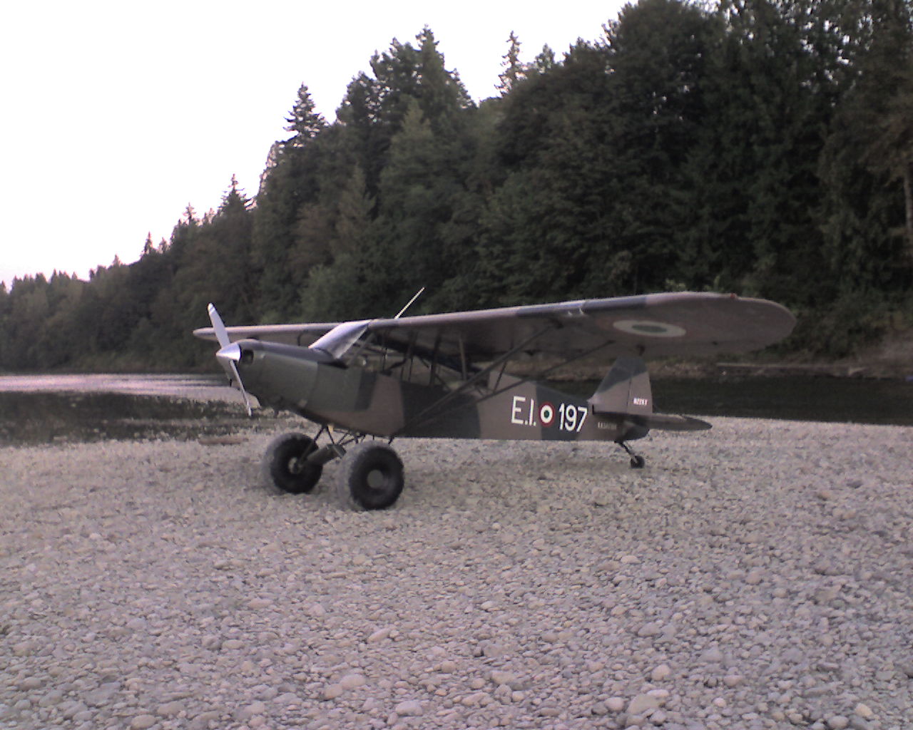

                    Its a 54' L21B that served in Italy from the mid 50's to the late 70's
                    I have the Italian logs and she is in pretty decent shape for a 20 year old dope cover job. Still has the 0-290d2 and the smaller AM series Sensenich prop. I put safety cables and the 31" bushwheels on. This airplane is very straight with no major dammage history and less than 3000 hrs total time.
