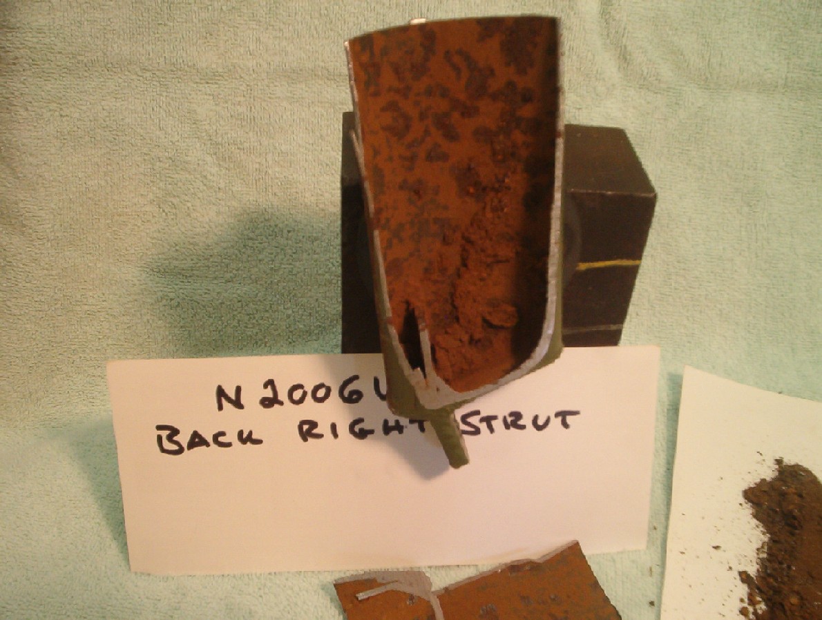

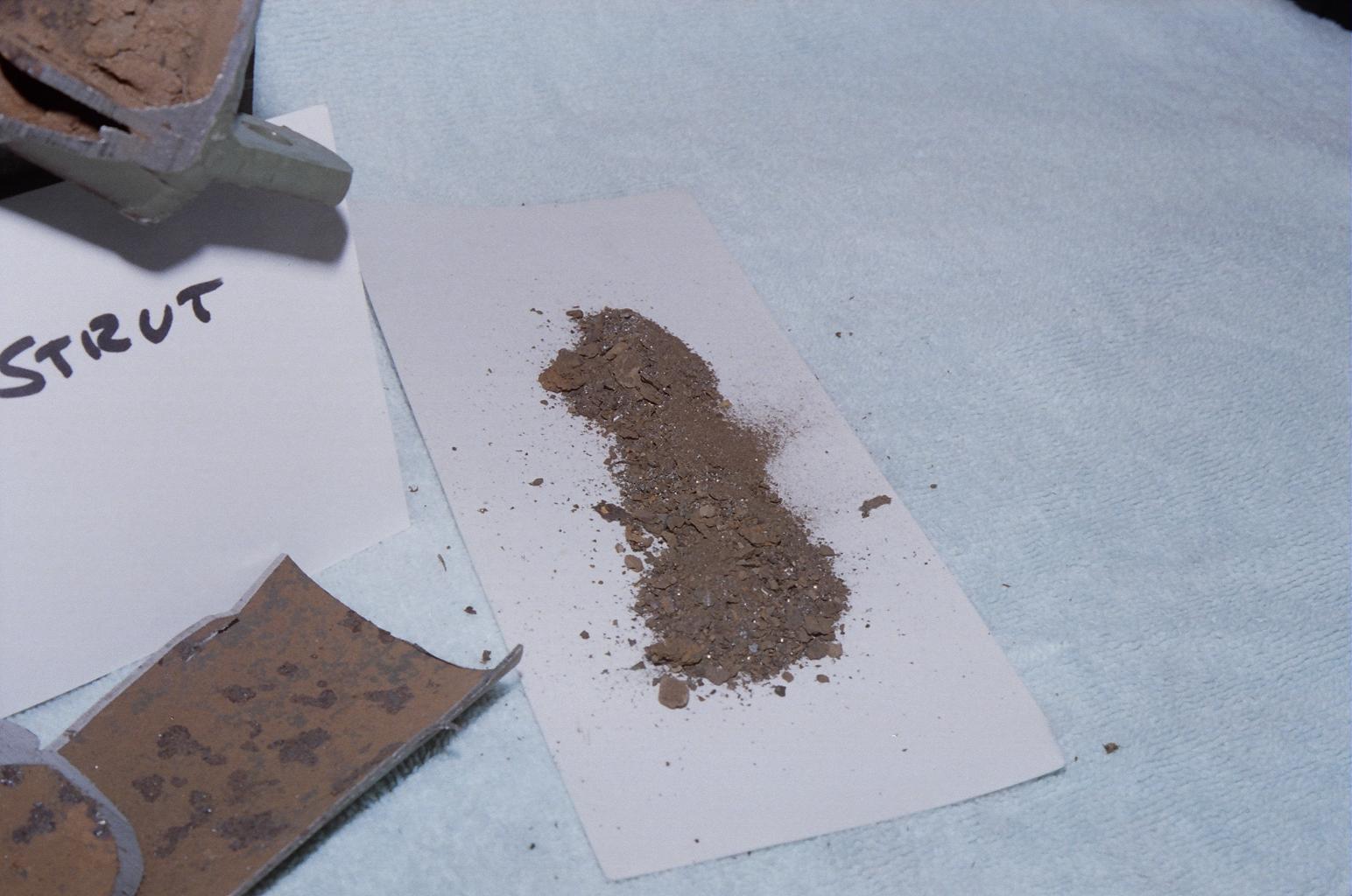

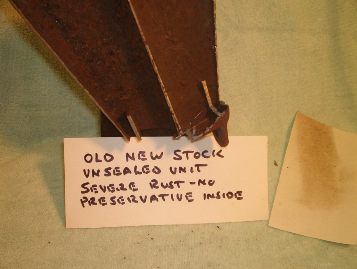

Some Rusty strut pictures
  • Some Rusty strut pictures
    Robert I have 3 more but need 400 KB limit to load them.
    I don't have answers about these and don't feel responsible to provide them.
    Here are some rustly strut pictures from airplanes for you to look at.
    That's all I can say, or care to.
    These are compliments of the FAA. Notice N number on papers.

    Dave, were those taken off a flying airplane or were they junkyard dogs?
    Despite the amount of rust and ugly debris, what was the wall thickness and how much strength was left in them?

                      Thanks for posting those, Dave. If that's what was presented to the FAA in justification of the AD, it makes much more sense now. Pretty ugly, but I'd lay my money on the idea that they weren't on an airplane that was flying.... but who knows... I've seen some pretty nasty stuff pass through some IA's that are either too lazy or don't know enough to look for it. It would be very interesting to hear from the owner of the airplane they came off of!

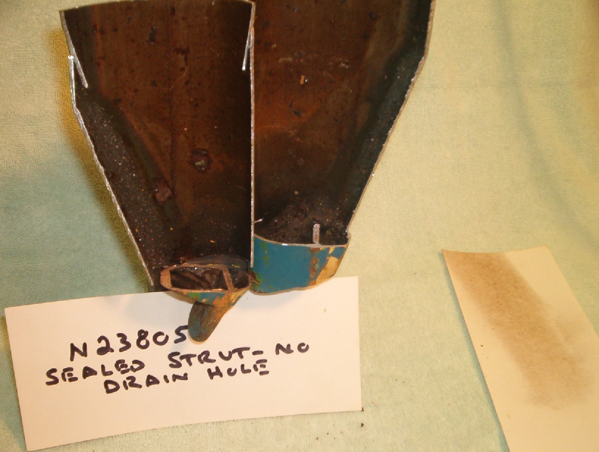

                            Am I missing something, or does the photo of the "sealed" strut show noticeable corrosion just like all the others?
                            What are we talkin' about here....
                              Re: Some Rusty strut pictures
                              That sure looks like more corrosion than I would think likely from entrapped air and moisture. Sealed is not always really sealed?
                              At least one of the struts looks, as pictured, like it still has pretty substantial metal left.
