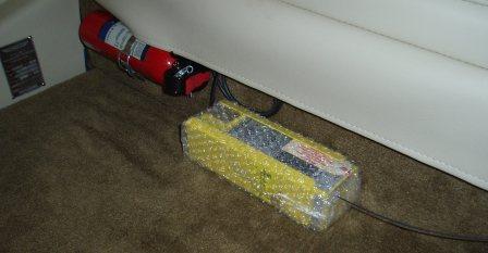

                I'm installing an EBC-502 in my restoration. It doesn't require an external antenna, which was its appeal. I'm going to mount it horizontally under my knees, beside the small fire extinguisher I have mounted under the passenger's knees. Easier to get at it there than if it were mounted behind the seat in the fuselage, and I figure the cockpit location also helps my weight and balance.

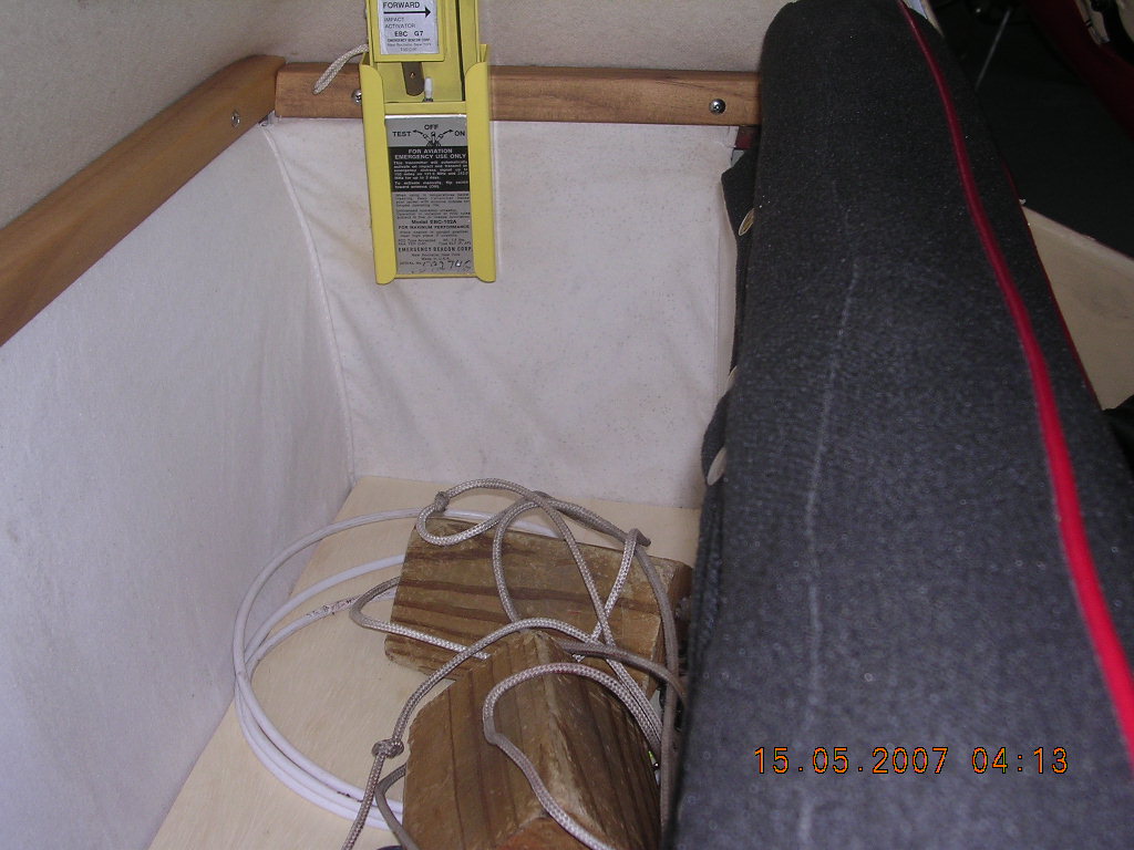

                    Buy the smallest cheapest one you can find see attached picture
                    Walter Hake TF#

                        Trouble is, that unit is approximately twice the cost of the Ameri King unit. But I am now beginning to lean that direction because of the ease of installation. What do the batteries cost on that?
