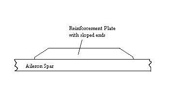

    The aileron spar has a reinforcement plate in it's center and it has sloped ends.
    See attachment. Any idea why the ends are sloped? how critical do you think that slope is? - Mike

    I susoect the slope follows the airfoil contour. It may be a clearance issue when the aileron swings upward as well as a leading edge fit issue.
      Re: Why sloped ends?
      My guess is that if it slopes longitutinaly it is there for stress relief Dick

            arg... I was thinking of the top and bottom but you were asking about the inboard and outboard end, sorry, my bad, answered wrong question.
            I think its a shrinkage and stress issue.
            Check out ac43.13-1b chap. 1 section 1.2, that may help.
            Actually keep going into the other sections in chap. 1 it comes up many times.

              Could be a build in lightness technique. The part of the wood that has been removed probably didn't carry very much of the stress.

                  Stress was a correct answer but it is probably better addressed as a "load spreading" device/design/technique. Don't want to go directly from reinforcement to non-reinforcement in zero length.
                  No doubt elegance does have something to do with it also. It would be ugly the other way.
                  Bet you will see similar stuff if you look in AC43-13 woodworking section.

                            FlyGuy is correct. The short answer is "to avoid abrupt changes in cross sectional area." Otherwise, when you flex the member it'll have a stress point right at the edge of the reinforcing plate and break there every time.
