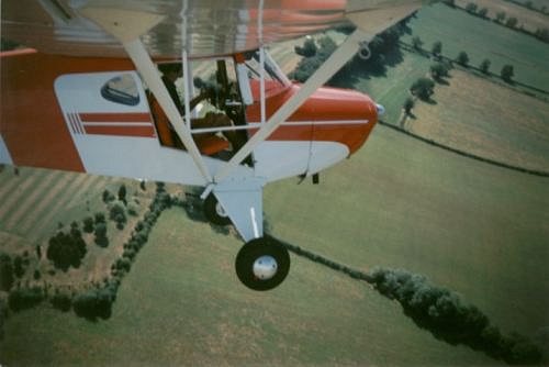

              Well I have never been known to fly with either of the doors off...(or both doors off, so I don't know who the pilot is in this photo of my plane).
              The cabin might get somewhat pressurised, so a robust headliner/rear cover might be useful to protect the aft fuselage from buffet/pressurisation.
              [USA rules may well be different to ours in England]
