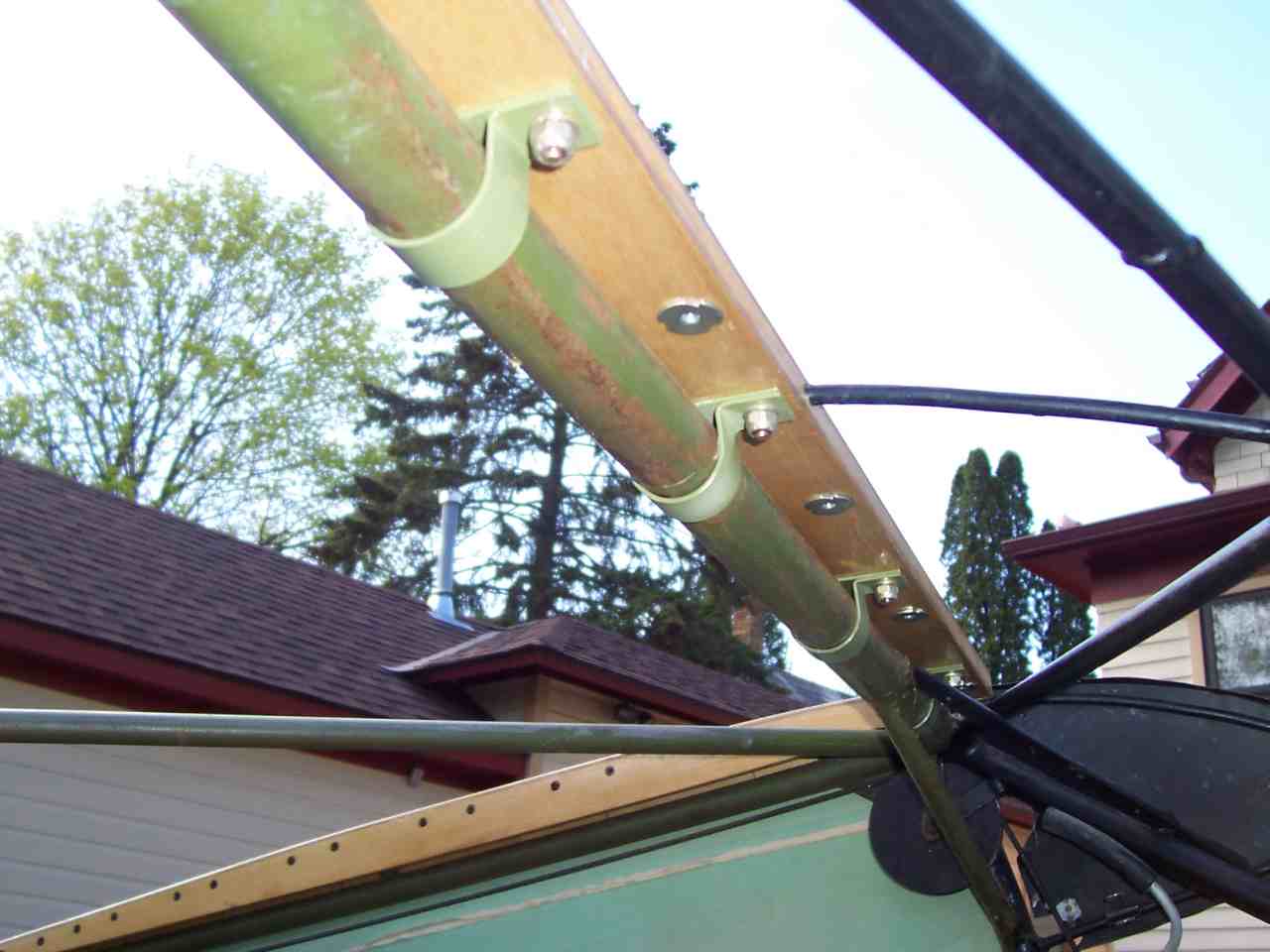

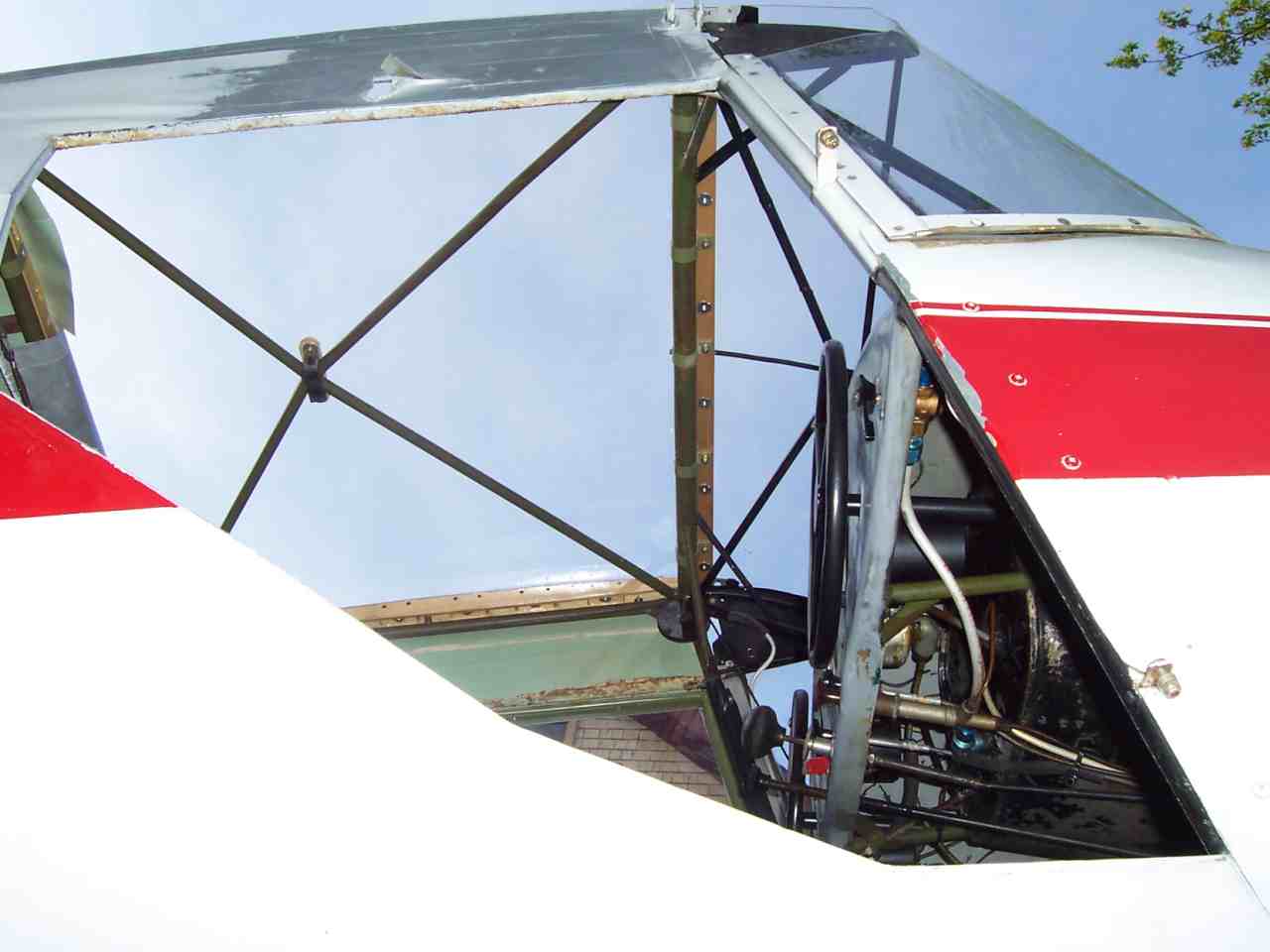

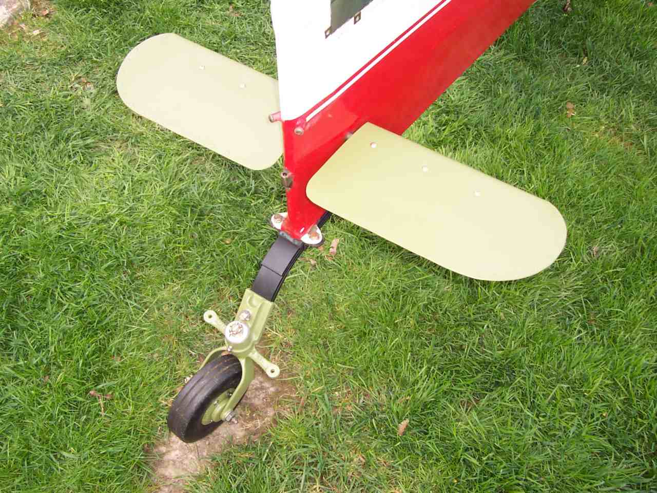

    Here are some pics of progress on 20407. We hit 80 here in WI yesterday....what a perfect day to work on "SWEET-T" all day!
    The new tailwheel springs lifted the tail several inches which looks much better. Refinished and added the new(to me) trim flippers and restored Heath tailwheel. Nearly ready to put the lexan on the skylite. I see why doors are serial numbered! I am guessing that each may have been custom fit to that fuselage. The replacement LH door that I rec'd does not even come remotely close to fitting. Lot's of mods will be needed to make it work.

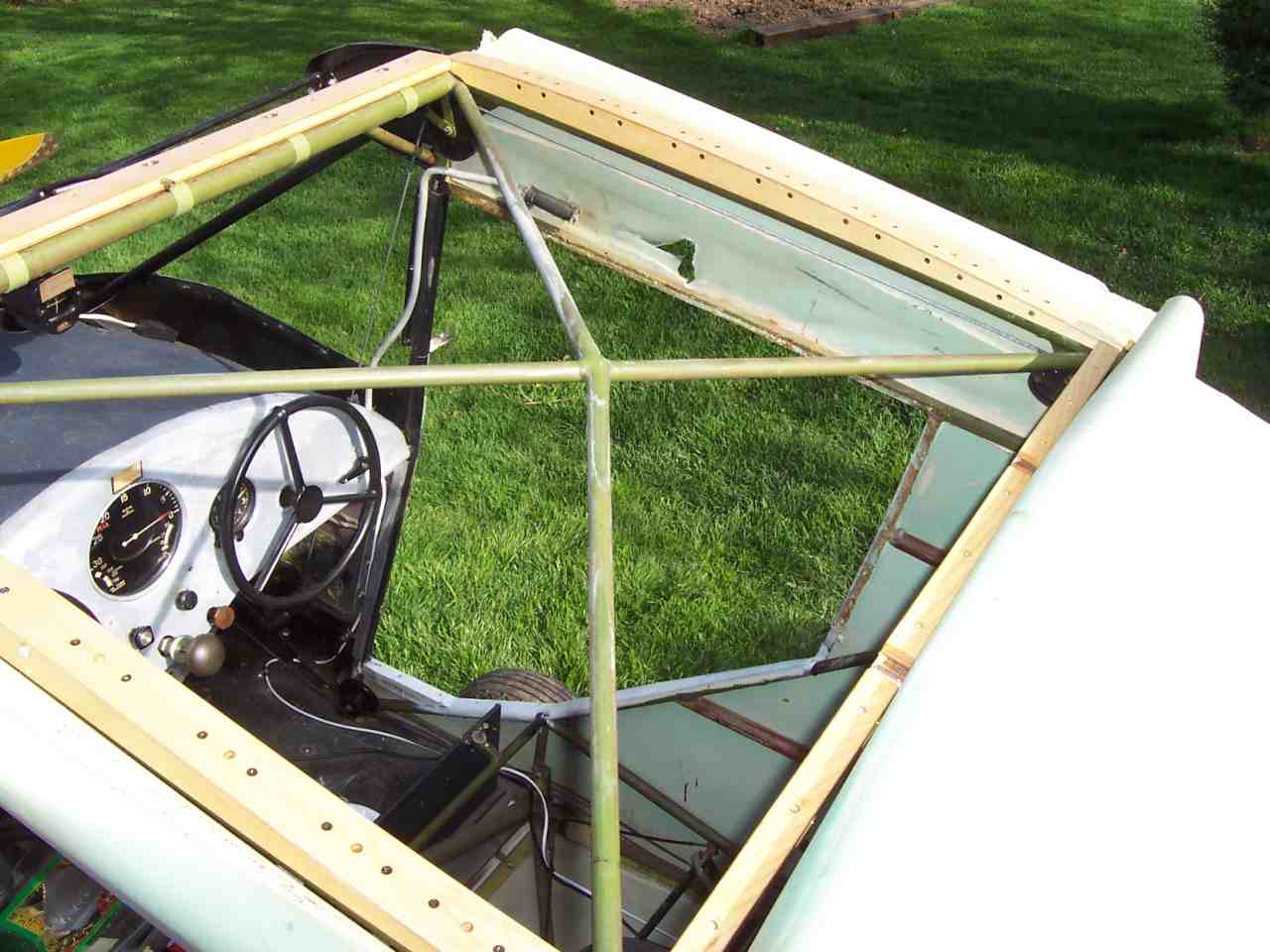

          Beautiful plane, What's that skylight design? Is that a STC skylight?

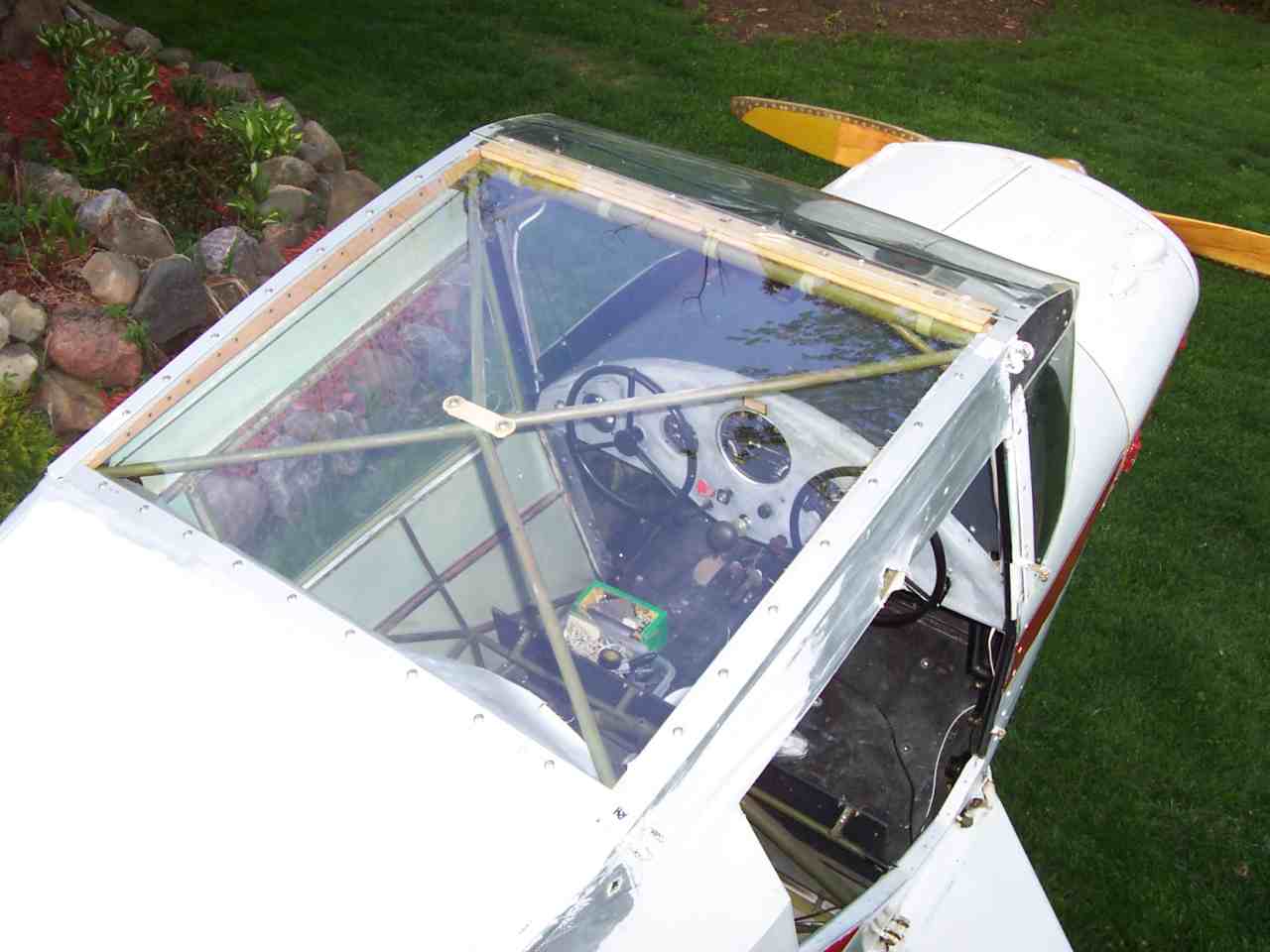

                The skyite design is Bill Berle's. I am working with my very supportive IA in using this well thought-out design. Getting this done and approved should lend support to Bill's design and approval process.
                Acrylic (Plexiglass) has 10 times the impact resistance of glass. Polycarbonate(Lexan) has 100X! It is about 10% harder than plexiglass. I used Lexan so that I could step down in thickness to 3/32"(.093) to save weight. Forms to the contours very easily. As Kevin stated, it is nice material to work with. The hardest part of working with it is leaving the darn protective film on until completion! I want Soooo bad to peel it off and see SKY! I should be able to get some pics tonite of the lexan installed.

                    Lot's of blue sky above!
