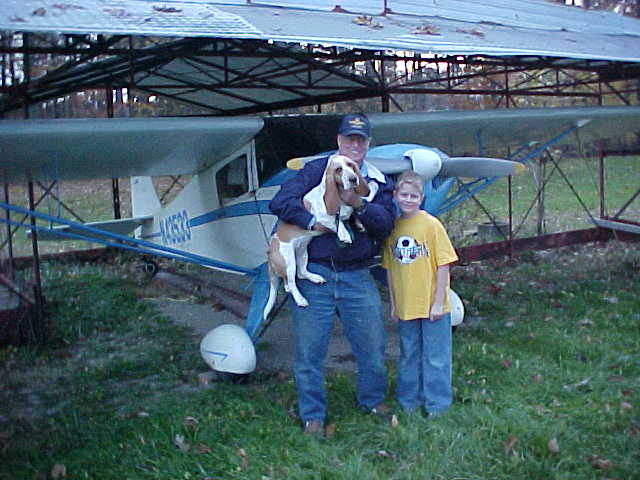

Well tribe...I dug into the airframe and engine logs to see what I could scrounge up. Here is what I found:
Tail Number: N36466
Serial # 4964668 Anyone of you know this plane?
Airframe:
3789 hrs Engine: TTE 1921hrs, 801 SMOH
1985 restoration that included: complete strip, sandblasted, primed, all new AN hardware, cables, New wing tip bows, new aileron, elevator and rudder hinge pins and bushings, new windshield, new Airspeed Indicator, Tach, new stab. wires, new Polyfiber Stits throughout.
small cracks in FWD and AFT landing gear attach points welded in 1964 and again in 2001
Bungees were replaced in 2001 (Time for new ones?)
Rear Spar Scarf Splice between 11th and 12th rib done in 1946, 337 filed.
1973 Damaged left wing by a club member and sold to EAA chapter for restoration.
Front struts replaced in 2004.
No 337 for rear LH strut splice!
2005 forward tail spring attach repaird after broken. No 337, repair look good, except that the covering was replaced in a manner that allow for easy inspection of the low point in the tail. (Good, Bad?) Owner says that it is easier to inspect for corrosion.
Engine:
Overhauled engine in 1966 with new parts. Again in 1985 with new pistons, refinished valves and seats, Crank run out .001 New mag points, condensors, bearings and ignition harness, new plugs.
It is unclear as to whether this engine crank was already turned .010 (the limit). If so, doesn't this mean that I will not be able to get another overhaul out of it?
Cessna fuel strainer installed with 337 documentation.
I am checking on Carb. I believe it may have the original Stromberg. I will check the "wired shut" item that was mentioned previously.
Mags were originally Eisman according to Engine Service Manual, however, the current mags has shielded cables so I know they have been replaced. Not sure if they are Bendix or Slick. Will pull the cowl off today.
Any other thoughts tribe?
$16000 includes 10hrs. of dual. Skis and extra 500.
Thanks again,
Eric
