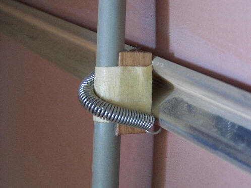

        I used the A/C Spruce sringers. They work fine. To splice, just lay one on top of the other and put in a couple of #4 sheet metal screws or 3/32 rivets on the sides to hold them together. The blocks are a different story. I made blocks with 3 different concave radius's to fit the fuselage tubes. The over all hieght of the blocks will vary to make the stringers stand out the correct amount from the fuselage. You will have to mount the stringers temporarily to the fuselage to measure how thick the blocks will need to be. I wraped anti chafe tape around the fuselage tubes and over the blocks so the springs (hardware store) wouldn't cut into the fuselage tubes. I can take a picture if you want.

            The springs catch each side of the "W". No I have not used them. To use the metal stringers on the belly, you have to use the metal bulkhead instead of the wood one under there and I believe they were riveted to it. Been to many years since I last used a set.

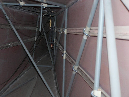

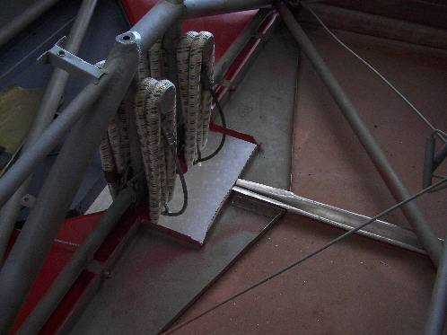

              Stringer pictures:

                    Originally posted by Bobdog View Post
                    Stringer pictures:
                    Bob, your plane is not safe to fly... too clean inside. Please apply Taylorcraft approved dirt and grease immediately
                    Personally, I believe that safety wire should be used instead of springs. Not that it would make a plane fall out of the sky, but thde springs could allow movement where safety wire would not. They also weigh a lot more than wire, maybe it would add up to a pound or two difference, not much but no reason for it IMHO either.
                    If springs were the OEM way to do it then great, nobody will question it.
                      Re: metal Stringers
                      Bill, if you look close at the stringers you will see a nice coating of Gila Bend dust! The springs were original, and hold the stringers very securely. (I didn't like the way it looked either until I tried it)

                        Bob, Like you photos and I wish I had seen it earlier. I replaced my bungees and I like the way you looped the safety cable around the landing gear. I did not do this and have to find a way to keep cable in the area in case of bungee failure. FYI when I cut the old ones off the safety cable did not catch. Thank goodness I had tied the wheels together and had a second rope on the engine mount attached to the roof rafters.
                        Dennis McGuire
                          Re: metal Stringers
                          I don't know if I installed the Bungees correctly, but the safty cable "wrap" came from the Univair service manual. Bob

                            Bobdog, Could you please send me some pictures of the fuselage and how everything goes back together? I need to know how the seat and the seatbelts go back in as well as where the stringers go. Any pictures of a bare fuselage would help. Thanks.

                              Locating the position of the stringers is important. You MUST first temporarily install the rudder and rudder cables so you dont have a stringer installed where the rudder cables are, The center stringer has to stick out the furthest from the fuselage, the upper and the lower stringers must stick out further than the longerons, but not as far as the center stringer. Use a straight edge to make sure. Also sight down the stringers to make sure they aren't weaving in and out. A little extra time here will pay off with a smooth fuselage and maybe even a couple of extra MPH.
