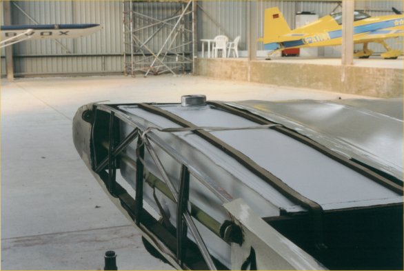

            Does anybody have a photo they can post of a 6 gallon tank in an uncovered wing?

              Yes.
              Photo here
              Full tank replacement story and more photos here
