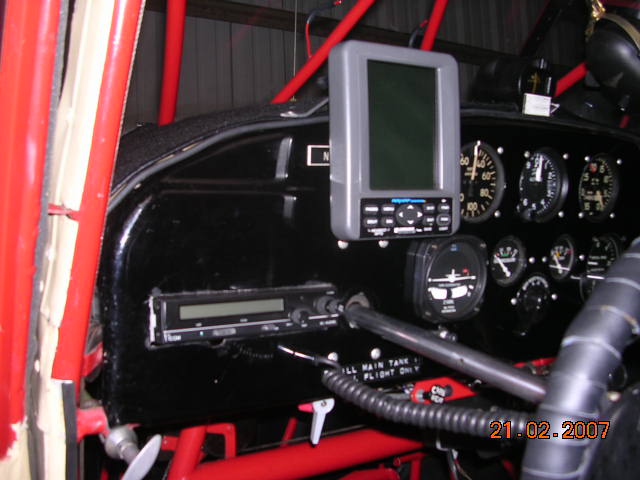

    I have a no electrical BC12D So I installed an Icom A-200 radio and purchased 7.5 amp. 12 volt rechargeable dry battery, it works great..it is worth $2000 for the total installation...
    I forgot to mention I have Slick magnetos and a shielded harness, add $1200 more...if I ever figure out how to take a picture under 125 kb ,,,I will post some pictures,,,brings my total BC12D value up to about $20M

                          I have post these pictures of my Icom-200, battery and sigtronics intercom they all work great...unfortunatly there is awire in front of the sigtronics face.
                          Walter Hake TF#
