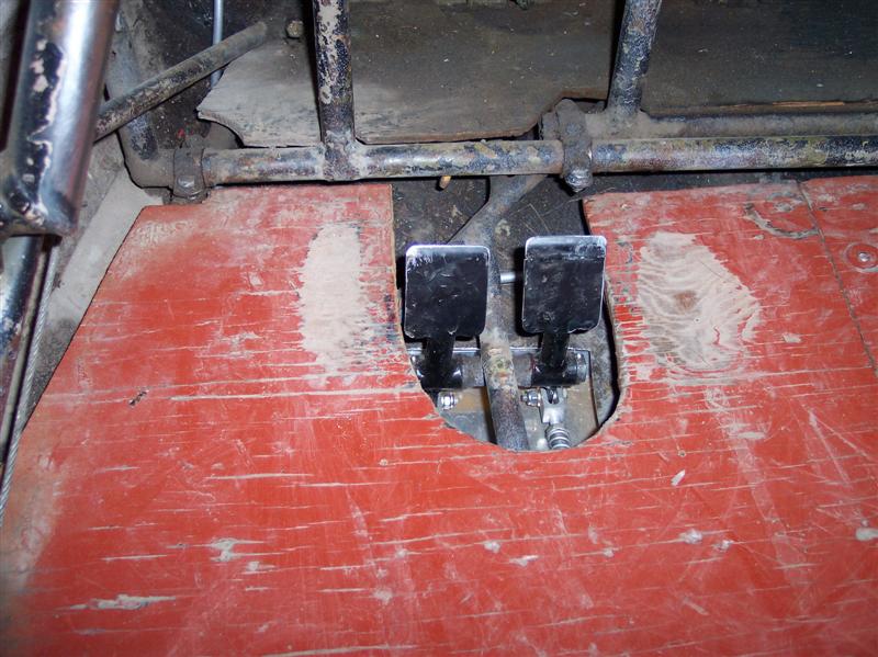

That looks like it will work, I've used those master cylinders on champs and they work real good. Single puck clevelands will work way better than the cable brakes. I mounted my master cylinders under the floor, but I had to do some welding to mount them. I used the same tubes for the pedals. but fabricated new pedals, that are bigger than the factory ones. Because my feet have slipped off when I didn't need them to and had a few close calls.Wolf Lake Aircraft Services

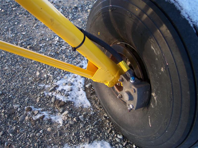

I'll take some pictures later and post them , also the F-19 gear fit the BC 12 D just fine. What I did was, take some 1 1/2 in axles from some cub gear that was bent and cut them off, slipped them over the old T-craft axle and weld them at the flange. They work great. I 've got a F-19 that I've been kinda parting out, if anyone needs the brake drums, shoes, etc , I have the gear also, but its bent up pretty good.Wolf Lake Aircraft Services

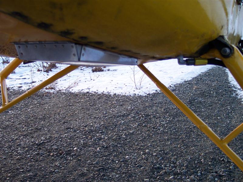

Dusty, here's a picture, I added two more pictures of the installation, I had to cut an access hole in the bottom of the boot cowl and fabricate a cover for it, its easy to remove an adjust the pedals or inspect. the brake lines are 1/4 alum tubing from the master cylinders to bulkhead fittings and then 1/4 in aeroquip down the wheel.Last edited by wlas; 12-12-2006, 13:53.Wolf Lake Aircraft Services
Re: My hydraulic heel brake system mock up
WLAS, that's more what I'd been thinking of... looks good! I like Jason's as it's easy to install, but I'd planned on hiding the m/c under the floor...

The flange on the PA-18 axels, that I welded over the factory axel is what I mounted torque plate to. I am working on getting them approved, but Its hard to get a chance to work on my own plane when I have everyone else's to work on. The brace I welded on the tie strut, I did many years ago, after I almost had it let go in some deep snow on a river. When I stopped the strut was only holding by a thread. I walked a mile or so to a cabin and the guy had a bottles and a torch. he took me back with a snowmachine and a piece angle that I welded on just to make it home. Its a must for skis.
