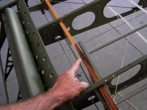

Hello Gang. I'm assembling my wings, and need to know if there is suppose to be a spacer between the lift strut attach brackets, (See attachment)
Thanks for the help, Bob

Yes, there is a little piece of tubing that goes in there. Can send a picture later in teh week or week end if that helps. Dave
Spacer is correct of course , that whole thing helps on negative loads when taxiing same as the little wire at the tip bow between the spars. Sorry I did not answer you directly but have been out for two days..... I still get about 30-40 messages a day.
