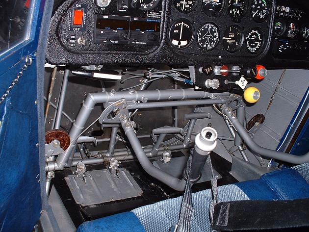

                    Jim:
                    As a tempter, here is the first of two photos of the stick arrangement in the British Auster. As you can see, the Taylorcraft heritage is evident, it looks like they took the "H" frame and chopped the top half off.

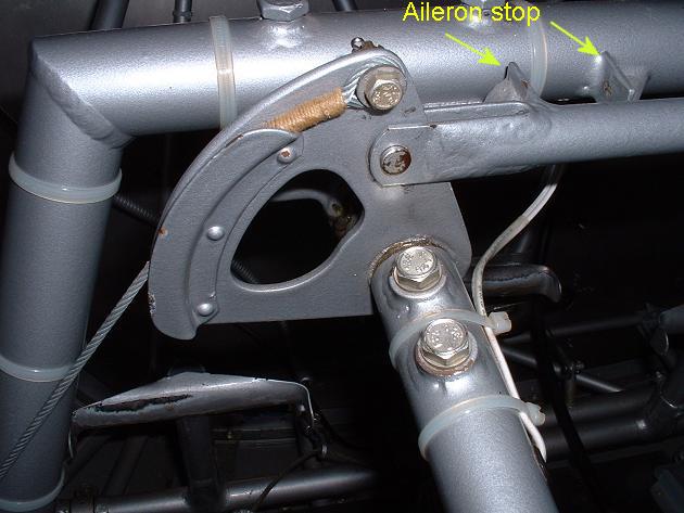

                      Jim:
                      A detail of the aileron control. Note the stops (in this view, the right hand bank aileron stop).
                      I will post the whole series of photos on the Taylorcraft Gallery in the next few days.

                        Robert , Many thanks for these and the ones you will post to the site. I have also heard from Forrest. He is helping me with this as well. Taylorcrafts and Taylorcrafters are the best and forever!!
                          ...well the gallery seems to be off-line (1826 hours GMT so I will post the to you privately, Jim.

                            Thanks Robert!! I now have them down loaded. Perfect. I am trying to call Forrest back now. Take care and thankyou again!! JIM
