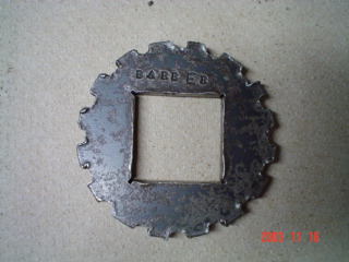

hang in until tomorrow, that is uder "special wrenchs" over at the airport.
It is a round piece of metal about 1/4 in thick with a 1 in square cut out in the center, with notches around the outside for a punch to be applied with a hammer to loosen them up . All mechanics working on small Cont. engines should have one then use the open end 1 in to turn it out. I will send a picture..Taylorcraft Foundation, Inc

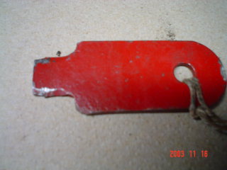

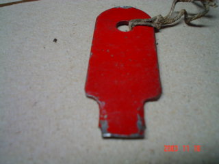

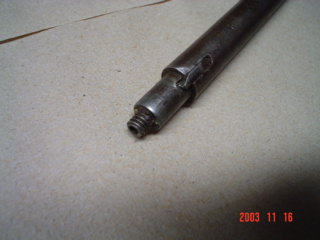

From the tool box of Al Barber, Taylorcraft 1945 & now Forrest
oil screen tool, , taper shaft Cont hub tool to hold out snap ring 2 shots , strut adjusterTaylorcraft Foundation, Inc
