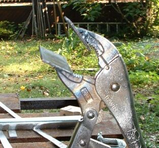

NEAT Bill! Your rule of thumb method looks a LOT easer than the complex way they showed us. It doesn't account for spring-back but all you need to do is use the brake to "bump" the angle to the final setting (takes all of a few seconds!). You DO still need to know what the minimum bend radius is for your material (or it will crack in the bend, and sometimes the minimum is DIFFERENT with the grain than across it). Also, some materials should be bent in one pass, not in steps or they will work harden.
