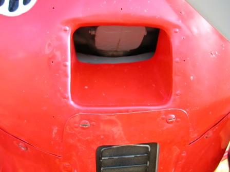

            My Continental 65 is also running at 200-210 degrees these days. My nosebowl, however, is missing the angled scoop riveted in the rectangular opening below the propellor (see attached photo of someone else's plane), so I'm sure I'm missing some cooling air around the lower half of my engine that way. Baffles probably aren't the best, either.
            I'm thinking of doing a compulsive factory-original restoration, using the original stapled wool felt gasket material around the baffles. Would that seal any better or worse that the modern neoprene gaskets?

                Most any C-85 powered BC12-D will run considerably warmer than the A65. My clipwing with the 0-200 ran at 220 on 90 degree days and both my BC12-D-85's run at 210+ on 90 degree days. The one I currently own has very tight baffles and has all the inter cylinder baffles in place. It also has the scoop that directs air below the engine and to the oil tank and it still runs at 210. The other day I was climbing to 4k and I was very heavy. I had to stop at 3k to let her cool off before going up. The density altitude where I took off was 3k (350 MSL).
                In my shade tree engineer opinion I think the Tcraft needs a less restrictive air exit. I opened up the lower cowling a bit on my clipwing and it dropped considerably. (20 degrees)
